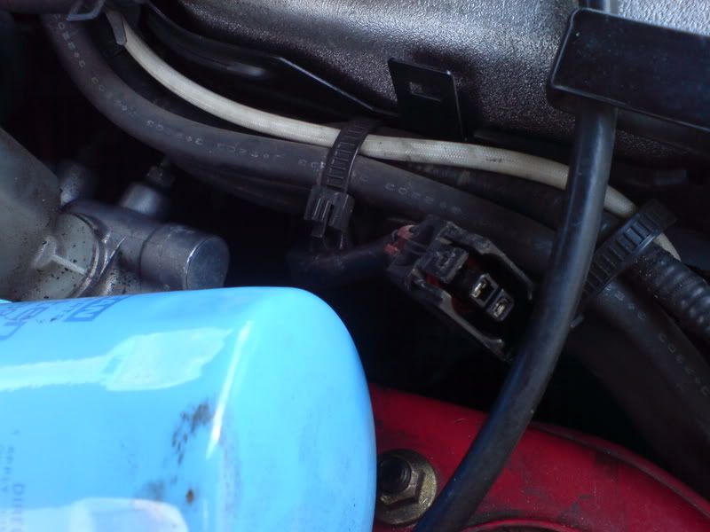

Picture from left side (passenger)

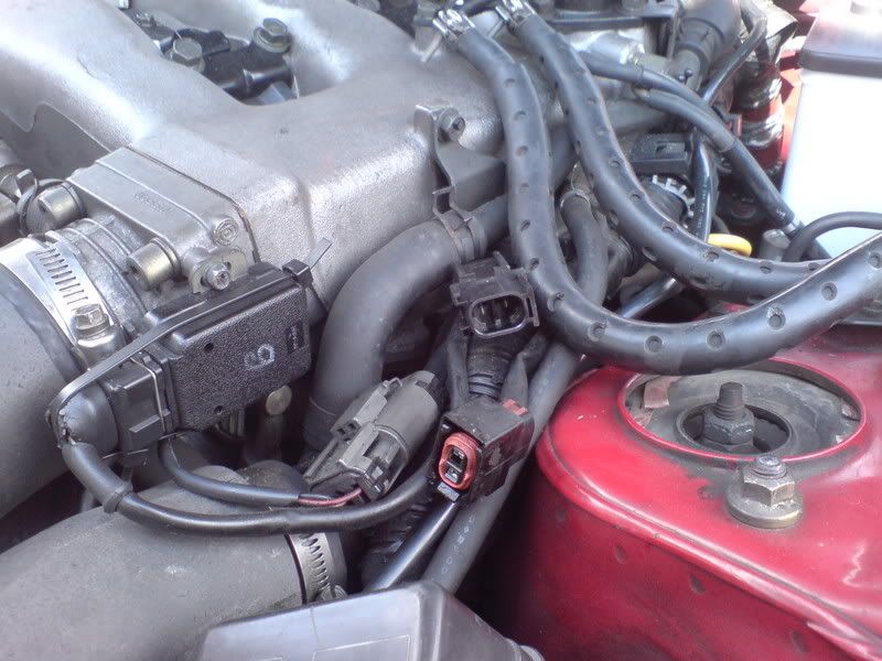

Picture from right side (drivers)
Also, is that the ptu thats cable tied to the inlet mani on the first pic?
Those look like the correct plugs to me. Also that device is the Throttle Position Sensor.

power seems right, maybe should be a bit higher at that boost. You've disconnected the correct plugs, and reconnecting them will in turn give you more boost as you discovered.
