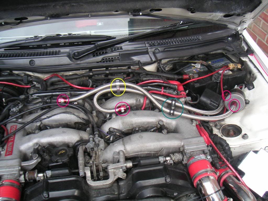

Here is a pic of my old engine with smithy's fuel pipe kit fitted, make sure yours is the same.
vbgarage.php?do=getimage&id=1067

http://i39.photobucket.com/albums/e157/Yampiedog/Pict7.jpg
make sure you have the pipe from the filter going to the drivers side connection
Sore enough T**T over here connected wrong way round :slap: :xxx:
Fuel filter to under throttle cover rather then to drivers side regultor :rolleyes: :xxx: :headvswal
