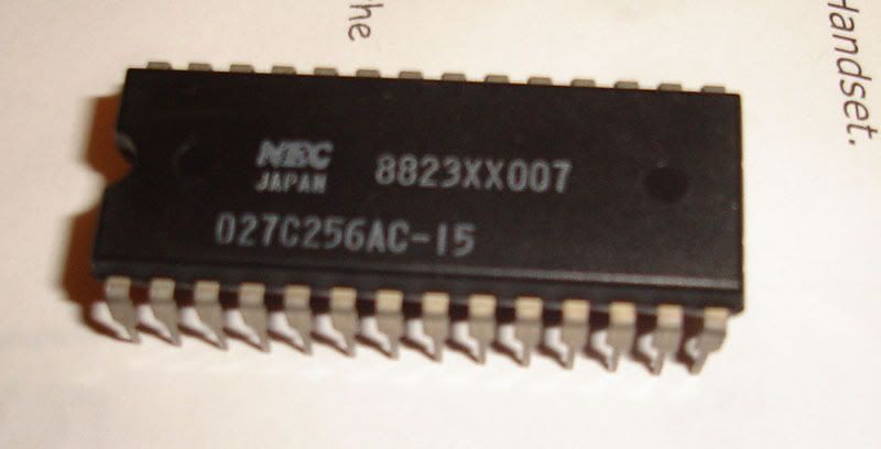

Deffo the right way round guys, the notch does point towards the center. Is there anyway I can check and see if it is a re-mapped chip? I'm guessing that if I show you a pic it won't help at all!!!!!!!!! Both chips were marked differently if that helps.

OK, most definitely not one of mine and no distinguishing labels, so I doubt anyone will know.
Thats just a standard PROM, 27C256 with a speed of 150nS which from memory isn't the best for the ECU -100nS or faster was recommended. You should be able to get someone with a EPROM burner to read the contents and compare with other tunes to see how aggressive it was or wasn't. If it wasn't soldered in, it wasn't the original.
