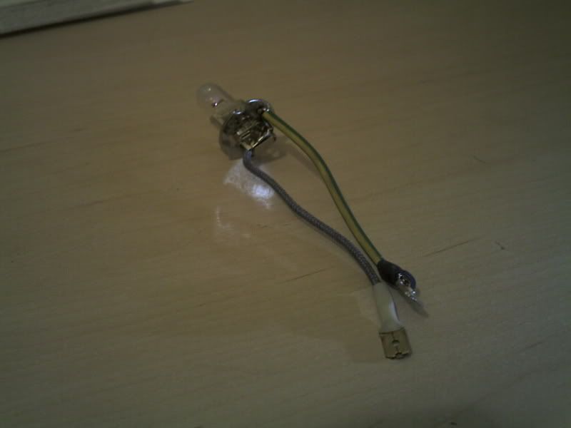

Right, I had a headlight bulb go out last week, so I decided to replace them both like you do, I was originally going to order up some H3C's, but decided to do the conversion jobbie with the H3 type as in the picture...
I had drilled a small hole in the plate and countersunk it also to ensure a good contact before soldering an earthing wire to it, with a spade connector as the picture shows, I did this with both obviously.
Then I fitted the modified bulbs and connected them up to the connector block, earth to earth and live to live.

there is a screw that you can attach an eye connector too on the lamp assembly. try that as otherwise you will have to solder a cable onto every bulb that blows.

What you've done is correct.
The only thing I can think of is that by drilling the hole to fix the wire you've shorted something in the bulb :confused:
I just used to scrape the silvered metal surface rough and solder to that but I did sometimes have the leads come off with the heat melting the solder.
Wiring the earth to the headlight internals gives the same result.
