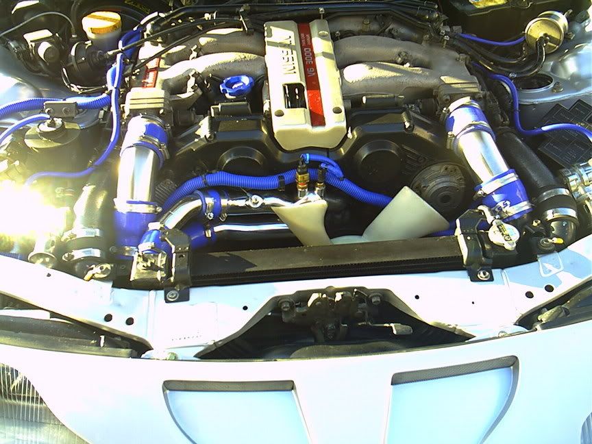

i've fit a pair of dump valves on the pipes at the top of the engine in the pipes. I've removed the recurc valves and blocked the pipes up as told and fed a new vacum pipe to the new valves. I've got no boost leak and they are'nt seized can someone please post a picture of top mounted dumps and the vacum pipes. Thanks in advance. (HELP)

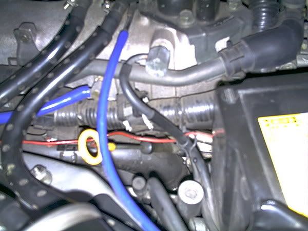

Ive got Blitz ones fitted and the vac pipes have been connected here :
It,s the bigger pipe on the left , N/S on the car
O/S pipe to balance bar .
Hope this helps bud :dance:
you would'nt believe how much of a help that is.
on the top picture whats the long blue pipe towards the top.
cheers mate.
cheers mate.
Vacuum supply to fuel pressure regulator

The original pipes they were on were replaced with some of Smithy,s stainless pipes , a mates an engineer and machined some flanges , cut holes in the stainless pipes and welded in the mounting flanges :dance: BLING
Here,s a piccy of the original pipes
As far as i know dump valves can be mounted on either of the pipes ( one to throttle body or one from the turbo to the intercooler)
I,m sure someone will correct me if i,m wrong :dance: HTH
Yeah they can go on either side - debatable which is best place they both have their advantages...
