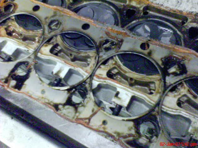

Thought i'd show you guys these pics, taken today of a rover 75
with headgasket failure, the mechanic is a mate of mine and had
this car in for the said job, he was utterley gobsmacked at the state
of it. The owner reckons it had only just started to show any signs
of gasket failure! (He's lying!).
He reckons this is just one of the reasons rover went under, using
cheap crappy parts like this headgasket, from a buisness point of
view he loves rovers, they keep him busy. But as a every day car
he wouldn't have one if he was given it, but saying that, he reckons he
might end up being given this one!
Cheap headgasket....

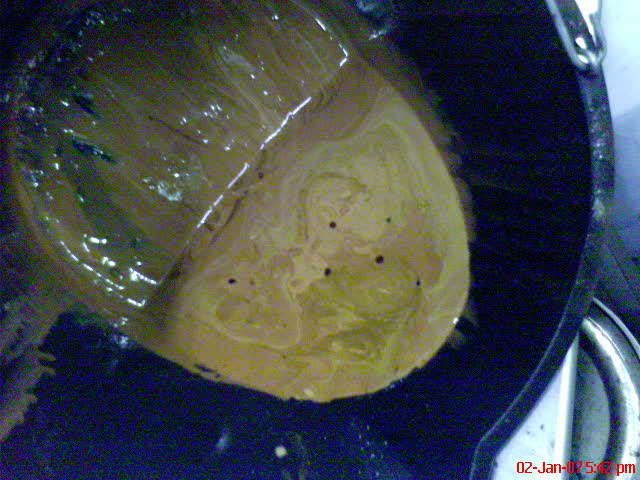

Is it coolant, or is it a sick bucket?

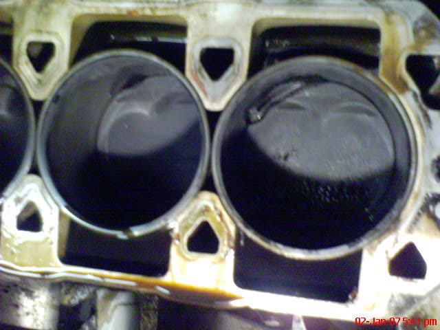

All this damage due to a crap gasket! Note the oil around the liners, there
should be coolant there, also the liners had moved due to the heat and
damaged the head!

That a metal HG?
Yep was a metal gasket, but it was the orangey 'dribble' that
did the sealing, just melted! :headvswal

Just read the posts above... There's nothing wrong with the parts (including the HG) - it's purely a design cock up. The K-Series was developed in 1.1L format for use in the Metro. The profile of such a car demands a fast heat up time - so they blindly put the thermostat on the wrong side of the cooling circuit - means the engine gets to operating temp quicker (better economy stats etc helps small car sales).
However, in that layout, you are effectively regulating the temp of the rad, rather than the temp of the engine... Not such a problem with a fwd mounted small low power engine - Metro's suffer very few HGF's relative to the other cars.
The 1.4, 1.8 and 2.5V6 used in the larger cars carried this 'wrong' thermostat location into the design - but now heat up faster and require much better cooling due to increased power output... The rear engine cars really suffer the worst because of the large cold coolant capacity of the pipe work to the rad... read the website for a proper explanation.
Classic support of this theory is the very low HGF failure rate of the MGF Cup Car - tuned engines and thrashed about... very few failures... why? because the thermostat is removed for the race spec engines to allow better cooling at the expense of warm up times.
