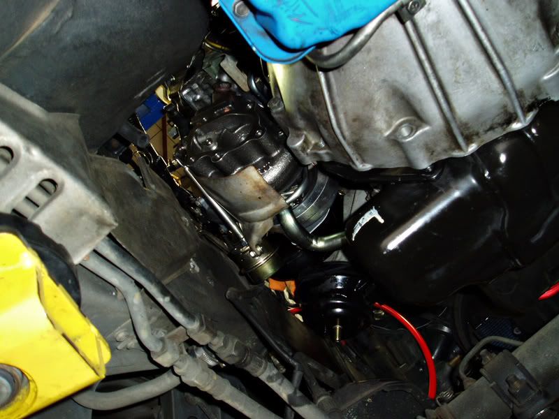

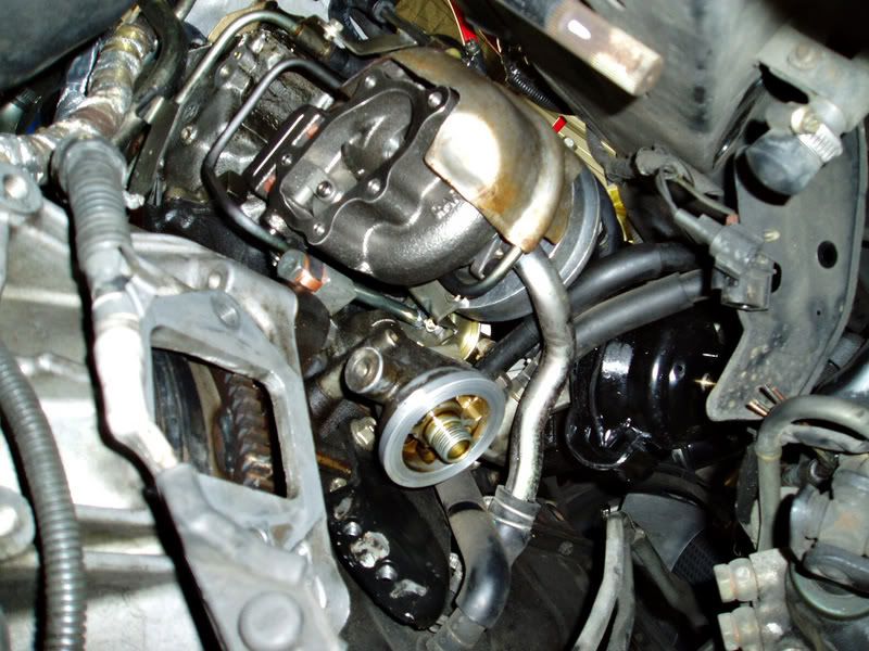

Just a quick update, the new turbo's are in. They look great, I can't wait to have the Z back on teh road again. Only think that is stopping me now is a pair of custom dump pipes. Here are a few pics...

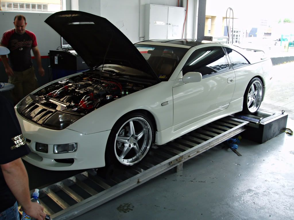

Results:
I went on the dyno last week. Had a few issues I still need to iron out, but overal happy with the war the Zed preformed.
First run was with stock boost and I made 210rwkw. We tried a few runs at 0.8bar and I made 239rwkw. Most boost we tried was 1bar and that saw 256rwkw. The was all with the stock fuel system.
The turbos were VERY responsive, couldn't be happier. Once I upgrade the fuel system, I should see around 290rwkw at 1.2bar.
