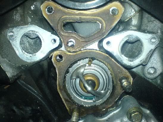

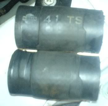

I have a small hole in a 3" hose just above the Thermostat so want to replace both 3" hoses and the 4 gaskets around that area, They are for a 1994 TT import if that makes any difference. Below are pictures of the 4 gaskets and two hoses. Does anyone have a picture of the parts page for this area? I did call in at the parts centre of Nissan, but they were usesless saying their parts catalogue did not cover imports but the one 10 miles away did. I said I was not bothered just give me the bits for a UK car, I would take the risk, but he would not look it up, said he needed full UK chassis number. Have left a message for dealer manager to complain....
if its just 2 little bits of hose like that just go to your local Pirtek office they probably wouldn`t even charge you the gaskets would be a different matter though
the rubber hoses or the metal pipes? Either way give mike feeney at MJP a call, he will sort you out much cheaper than a main dealer and won't fook you around. Also, there are no gaskets there as standard, just liquid sealer, somebody has replaced that before.
14055 F6511 Hoses 4.30 each plus VAT
KP710 00150 Liquid Gasket 28.40 plus VAT
30 quid for liquid gasket! lol
bet they sell loads of that, try Loctite instant gasket and with the money you save have a few drinks Friday night.
See hose 14055 just above this writing. Part Numbers:
14055-F6511 Hose-water,bypass
24220-F6500 Clamp-hose
21014Z is the liquid gasket, you can see the tube. Part Numbers:
KP510-00150 Date:01.90 -01.94
KP710-00150 Date:01.94
