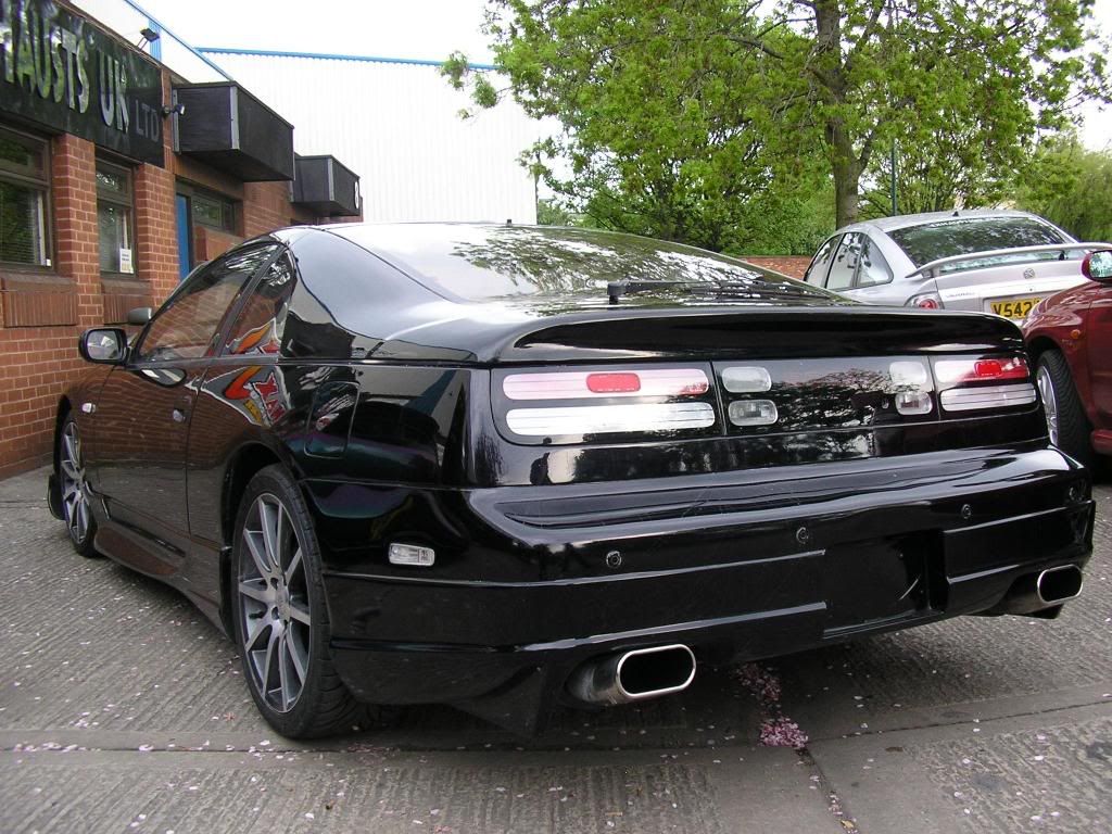

Well got back. So basically, finished fitting the exhaust at 5pm, been stuck there all day.
We tried to patch up the leak by fitting a t shaped rubber seal with a metal tube inside to clamp the outside of the plastic to in the vain hope the rubber seal would stop the water coming out.
Started it up... and it leaked so decided to drive to the local pizza hut, call the aa and wait there.
Exhausts sound good, boomy but not too intrusive inside the cabin even with the seats down and no sound deadening in the boot lining.
Got out and popped the hood and the steam had stopped leaking, temp was normal so thought, fu*k it, i'll try and see how far i get.
Heater on full with the fan on to aid cooling, keeping a distance between me and the traffic.
Got two junctions down to 32 then bang, big steam coming out.
Plastic had cracked and the killed the rad. Pullled over straight away, aa came and brought me back by 8.30pm
Spent the rest of the night trying to remove my old rad to replace with my spare one using a wind up torch in the pissing freezing cold (5 degrees c brrr)
Couldn't get enough pressure on the bottom pipe to secure it while i tightenend up so basically it dumped about 3 litres all the way down the road and back.
Now the car is stalling, stinks of petrol, and there's popping in the exhausts and i assume the temp sensors wire which were on the cats is the thing that's hanging down rubbing against the floor.
I may have completely fooked my car in under a day! I need sleep to get rid of this headache :cry:

nice nick can not see from the photo but are the pipes the same as on this one

Sarah, yep they're exactly the same exhausts. I didn't know you had those originally? Why did you change them?

i did not change them for any other reason than that i could!! i asked for it louder and pete just put the new ones on
lol, you said when i asked you that you asked for them to be not too loud and you got a headache with the roof off :D
