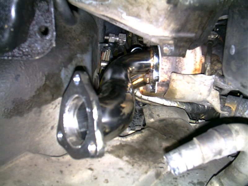

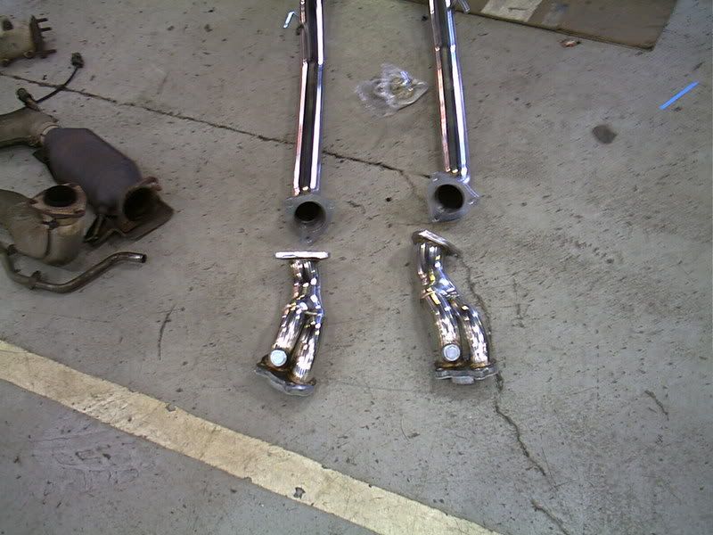

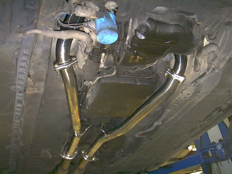

Finally got round to fitting them :dance: There the JAPSPEED ones sold on ebay by 2Fast2Cool , nice quality and had no fitment issues at all.
Managad to give it some welly on the way home , you can certainly feel the difference , power comes on stronger and lower down than before , just feels alot livelier :nana2: :nana2: Would reccomend them.
The worse part is removing the original downpipes and elbows off the tubs , had to heat the downpipe bolts red hot before they,d budge and you need hands like a 5 year old to get to the top nuts on the elbows , but after lots of skin loss and swearing i managed it :dance:
Only problem now is it,s smoking like a train , i knew this would happen , i,ve fitted the pipes in rediness for pulling the lump out to replace the worn tubs.

Yes it was bud, but not as bad as now :smash: , got a pair of tubbs ready to go on , gonna pull the engine out down at mantav8,s house but he,s already sold his lift , that,s why i got these fitted now so we,re not struggling to undo rusty exhausts underneath a jacked up car .
