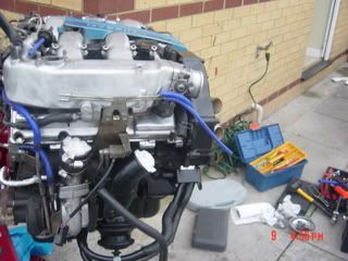

il get me lump back in saturday! i would be doing it at the garage but theres 15 zeds there at the mo PMSL so home rebuild!, only good thing is i can take aslong as i want few pics anyhow, fingers crossed for a dry weekend :smash:

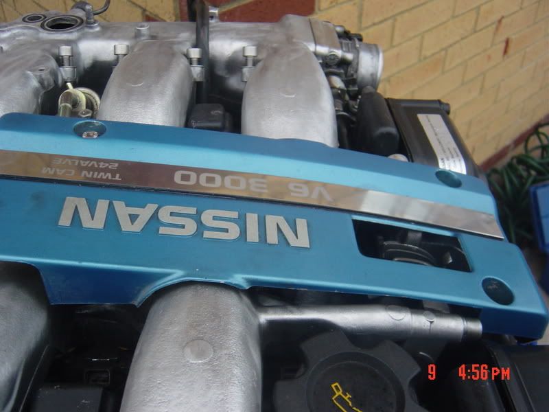

:shock: top man .....is that a bit of PITTING on number 4..... :nono: ...
... :rofl: :rofl:
... :rofl: :rofl:
well it wasnt there :rofl:
Are you Blind ..or ... do you have RED EYE .... :rofl: :rofl:

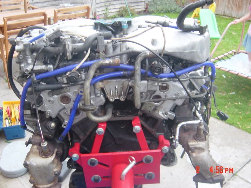

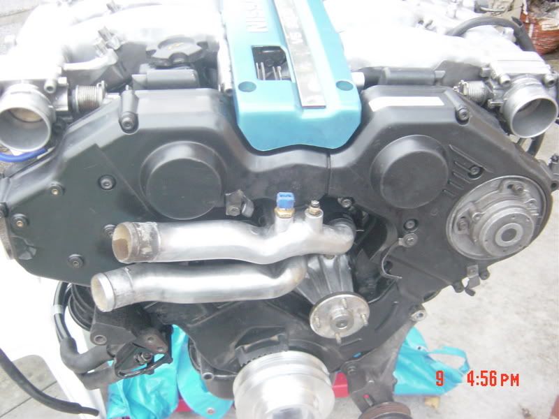

not really mate iv replaced loads
cambelt
tensioner
x2 water hoses
thermostat
crank sprocket
crank oil seal
x4cam oil seals
cam o-rings
idler
sgp lightweight pulley
temp sensor
fuel dampner
Head gaskets
intake manifold gasket
x2 oil return gaskets
rear main oil seal
x2 exhaust/manifold gaskets
turbo downpipe/elbow gaskets
x6 spark plugs 11b
both turbo feeds
EGR removed and welded
heads skimmed 0.005" valves reseated and new VS oil seals
lifters
full upper bypass
pcv valves x5 hoses
polished rocker covers
lots of new hoses here and there
6 new coil pack connectors and 6 new injector connectors

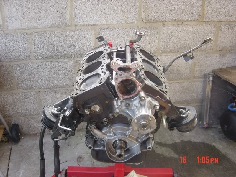

turbo's are in good condition as is BE problem i had when i bought the car was. Soon as you pour water in to radiator it would expel between head and block even when car wasnt started :shock: so all iv done is topend rebuild.
