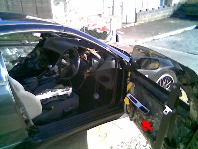

Alfo, all it needs is a small motor that extends an arm when used, this connected to the cables, pulls the lock to open, that simple, it can be fitted anywhere along the run of the cable provided it has sufficient reach to open and not foul the door card, mine is fitted more or less about elbow are when sitting in car, best i can describe really.
when you look at the door with no card, bottom right you will see a hole, at the top of the hole, you will see a cable runnig to the front, with the door closed and locked, pull the cable, and you will find it opens. just mount the unit to the upper metal work and your on a winner.
this is for guidence only and i take no responsibility for the fitting mate.

anyway, here is an old pic i found with my door card off, you cant see the unit, but i have blobbed a red dot where it is fitted.

Is yours a 90 or 91? Mines a J91 so they should be the same right? I'll show him the thread and the pictures you posted. I don't wanna risk taking the card off myself for fear of not getting it back on again.

91 jap import mine is mate
