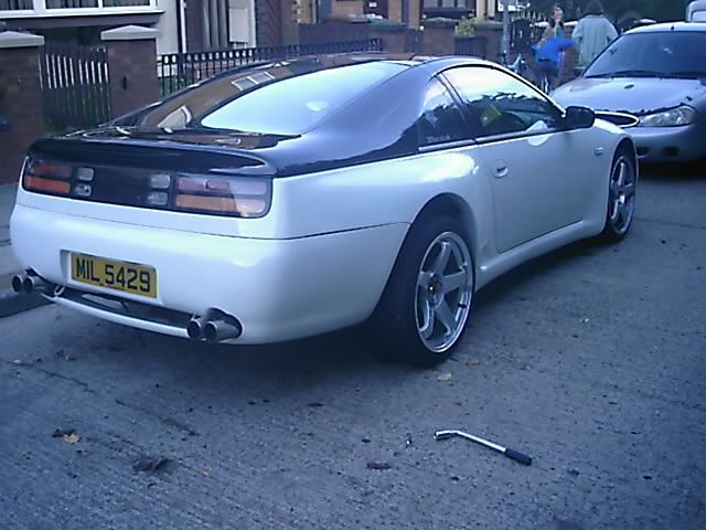

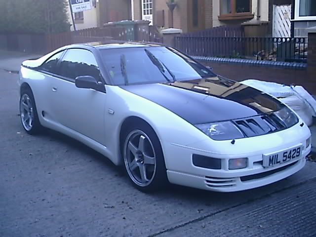

some pics with spacers on, although not my spacer (they are too wide) getting ine made this week
and it sits high cause i had just dropped it down off the jackand it needs to settle
you get the idea though
