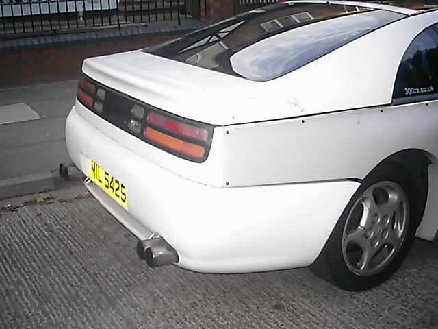

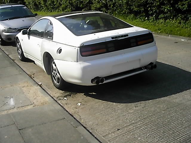

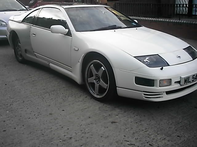

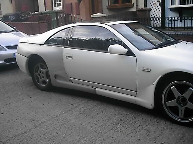

been on all afternoon cutting and welding my arches ready for the kit to go on tomorrow
also took the rear bumper off, which was a pain in the arse
so here are some pics, i hope i cut them correctly lol
looks like i will owe my dad some stella's on sunday :duffer: :duffer: :smash:

Dont know if you know bud but the standard bumper is too short if you stretch it out to the wide arches, it dosent come right up to the wheel arch, this is how i did it.
You can see how the bumper is short
I made a steel mesh frame
Add lashings of fibreglass
Made a metal plate for the inside and glassed it in place
Blended and sanded
The finished job. Cheaper and nicer than the strosek bumper in my opinion.

once marked, which took about 10 mins, i took approx three hours to cut and weld the arches, unfortunately because i was in a hurry to do this i couldnt take step by step pics
but i will try and sort something out later, its a piece off piss to cut and weld them, we even used a grinder instead of a air hacksaw

the arches and rear bumper are on, will get some pics tomoorow
thye need a bit more trimming and then sticking on with fibrol, wuwhooooooooooooooooooooooooooooooooooooooooooooooooooooooooooooooooooooooooooooooooooooooooooooooooooooooooooooooooooooooooooo

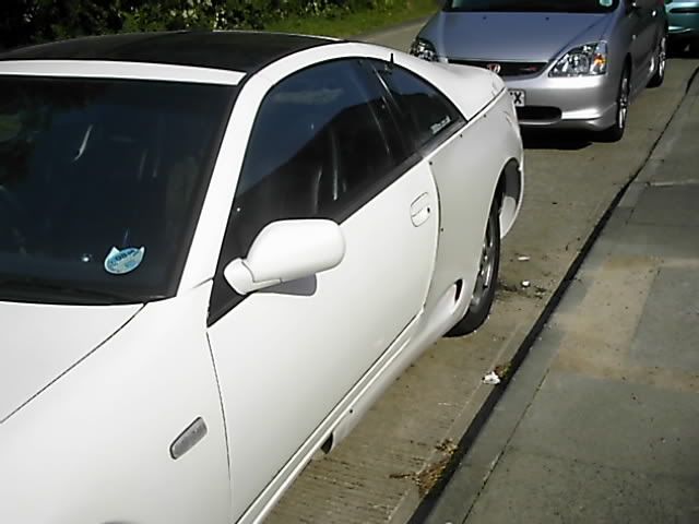

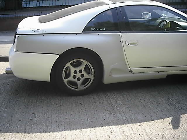

got some more pics
the panels are all on (only screwed at the moment), they are ready to be stuck on with fibrol (which peter will be doing this week) then its off to the bodyshop wuwhoooooooo
