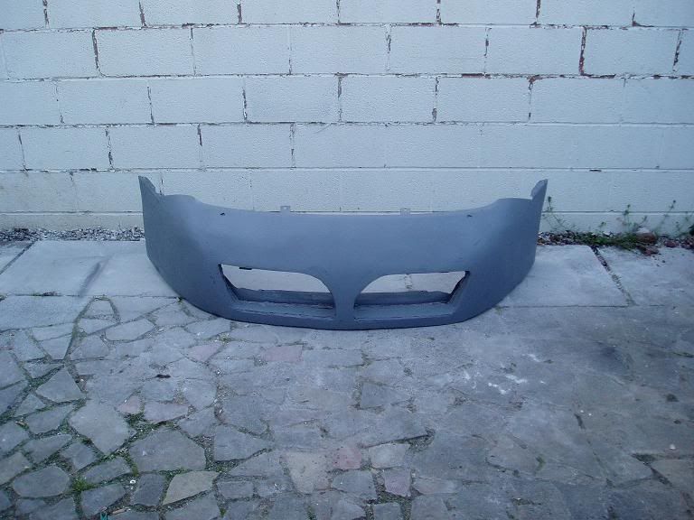

As an arty-farty type I used to do a lot of sculpture and although I mainly paint nowadays it crossed my mind that maybe it would be cool to sculpt a custom front end loosely based on the R390 for the Zed. Thankfully I have no sense of reality whatsoever and went at it. TBH I never intended it to go on my own car as there's already some great custom work being done to it by someone who actually knows what they're doing (Steve at Bodywork Plus), I really just did it as an excercise to see if I could. Below is a very rough work in progress shot of whats been done so far (very rough indeed as I'd just put a fresh layer of filler on and hadn't smoothed it back when I took the photo!):
It's still a very rough shape but it's getting there...slowly! Seems to be going to plan as well. It will retain almost all of the original mounting points and will have the same recessed fog light and plastic cover (though I'm in two minds whether to include the "blade" that runs across the two main openings). If all goes well it will also be made from ABS plastic rather than FG...a nice halfway house between FG and PU that I can cast myself...more flexibility than FG and it's easy as pie to fix if it gets a ding.

i like that buddy. nice to see something completely original
cant wait to see the finished results. hope it all gos to plan
That looks smooth and still keeping the lines of the front to some extent.
Post more pics so we can see how she goes.
looks promising, nice one mate! :bow:
wish i could do something like that, hows it done
it looks like a micra bonnet grafted onto the zed bumper lol
Lol! Bugger off! ;) :D [damn...I can see your point... :rofl: :rofl: ;) ] Hopefully it'll take on a different look when I've cut the fog apertures out and the bolt on covers go on (will be picking them up from Demontw@ts when I'm next over in Wrexham sorting out V8 stuff)
Er... very Heath Robinson but I built a rough shape in polystyrene over a stock bumper (it's still under there!) to get the lines right and to keep the mounting points. Then drew up some templates from my initial designs for the main openings, built up a negative of them in wood about 2" thick, fibreglassed around the edges and fixed them into position. Also used a lot of thermo-plastic (an absolute godsend) to mould edges and curves more exactly. Once it's finished I'll take a mould of it all, make a copy, graft it onto a better bumper to again keep the mounting points (the one I used I had to repair as it was almost in two pieces and some of the mounting points were fVcked), cut out the unecessary bits of the OEM bumper, do some fine tuning and take a final mould of it all again. When I write it down it seems a helluva lot! Lol! :D

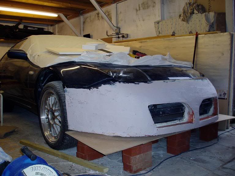

Well, she's coming on slowly but surely:
Managed to get a fair bit done on it today as had some free time and the weather was perfect (managed to burn my back though! Bugger! :D).
