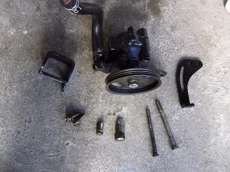

from the pic below, am i missing anything ? mounting bracket perhaps ?
also the hose that is still attached, that goes to the power steering pot ? and finally the hose missing from the top is the one you mentioned about needing replaced ?

sorry bout the delay bud. right. the bracket on the far left of the pic needs to be reduced buy about 8-10mm as it sticks out too much. you will need the mounting bracket for the NA pump ( these are made from alloy and not cast like the TT one), as for the pipe in the pic thats ok. its the high pressure hose that comes out. you will need one off a NA.
other than that bob yer pully on the other way round (so it pertrudes abit more) and jobs a gud en ;)
hope that helps matey
