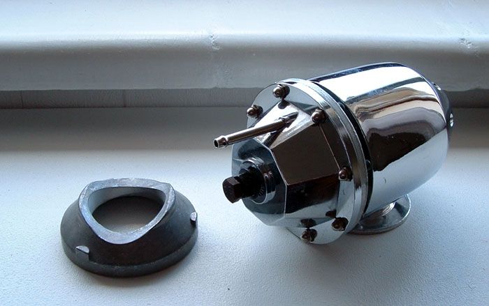

got these hks i belive today can they have fitting kit for replace resercs or are they hard pipe fit only.thanks :confused: :confused:
Could either really but fabrication is involved for both!-don't know if there is a specific kit to replace recircs,deffo one for h/pipes tho' ;)

Looks like hard pipe only. Mine got a different metal endpiece so I could replace the recircs with the bov.
thought so, yes they can be fitted in the recirc pipes mate, buty you need a fitting.
basically, get an elbow of tube made, and weld the flanges that came with them on the tube.
pm legrath, he has them, he may know where they came from, or be able to point you in the right direction.
wont be expensive though mate
the plan is i can get my welder at work to do this if it will work on your advice ..were the big hole is get him to fit metal pipe in and weld it closed and expand the other to fit inside the old recerc pipe ,,,,will this work..
all you need, is an elbow of tube with the flange on the end

yes fella, they have screws on the top, and they can be shimmed if needed too
Heres a pic of the flange mate
you need to buy a pair of these that fit your BOV as they come in 2 different sizes, they are held on with a cir clip, then your welder needs to weld the elbow into the flange to fit in place of re-circs, howeevr if you decide, you can fit them on the pipes in engine bay, ideally hard pipes is so much easier ;)

hi smithy i have the flanges with them going to get him to weld pipe into flange with bend on then fit onto bov and into reserc old pipe,,that should do it ..what do yous think
any one now what size the pipe has to be going into the old rubber one
IIRC
BOV return to intake pipe is 28mm (the one you block off with a blanking plug)
BOV to IC pipe is 32mm (the one you fit the BOV too)
