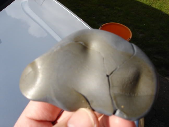

Here's a clay that's picked up all the surface crap not brought off by hand washing.
BTW, car has to be totally dry for the clay to work.
