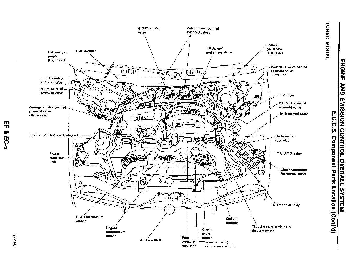

I have managed to snap one of the (ridculously brittle plastic !) pipes (ringed) on this part when changing to silicone vacuum tubing. :headvswal
Can someone tell me what it is - or even better let me know if they have one going spare ? I did a search on the number on it but didn't find anything. It is located on the drivers side (one of two). Any help appreciated...

looks like a solonoid control valve for the waste gate control.
but i could be wrong, please shout out if i am

Looking into it a bit more I think it is either the EGR Control solenoid valve or the PRVR control solenoid valve....the pictures look exactly the same - is there any difference ?
http://www.300zx-twinturbo.com/cgi-bin/manual.cgi?list=efec&dir=&config=&refresh=&direction=forward&scale=0&cycle=off&slide=19&design=default&total=190
http://www.300zx-twinturbo.com/cgi-bin/manual.cgi?list=efec&dir=&config=&refresh=&slide=18&cycle=off&scale=0&design=default&total=190
It's the EGR, as the PRVR is on the lefthand sus turret in front of the battery.

Cheers Dave and Yampiedog
There is another solenoid right under this one - what is that one ? They were connected to each other.

The PRVR solenoid is next to fuel filter & AIV, EGR solenoids are next to brake fuild reservoir.
