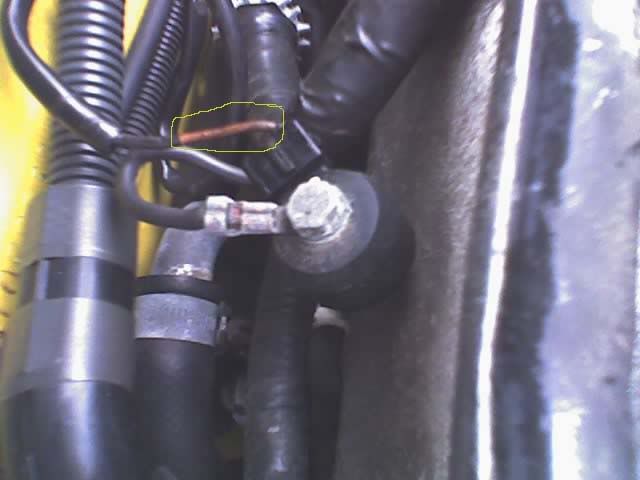

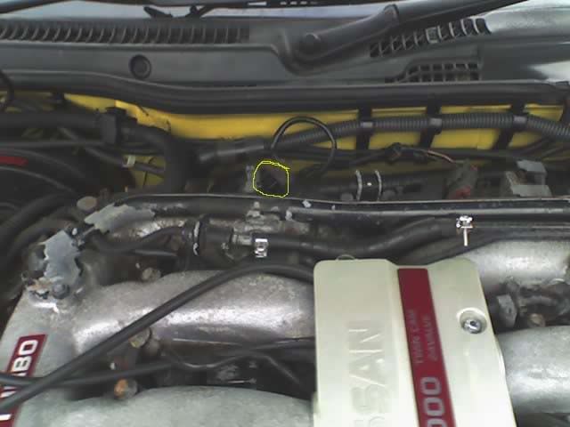

Had a quick look at the det sensor harness today and found what i assume to be the det sensor on the top of the engine.
I pulled back all the black electrical tape to discover only one wire coming out of the connector on the sensor, it looks like when it has been moved the end of the harness lead which is supposed to plug into the sensor has been removed and the wire has been soldered directly onto the pin in the sensor.
However as there is only one wire going into the sensor I would assume that this is probably part of the problem. If the ECU can be frigged into thinking there is a working sensor there by putting a 1Mohm resistor in then my ECU will be seeing an open cct and throwing up the fault indication.
yeh it is the det sensor, not sure what it will do there lol as it wont be measuring much?? tbh you might as well bypass it as its useless now anyway and with regards to the hicas just bin it, get a hicas bar, lock it out, sorted ;)
