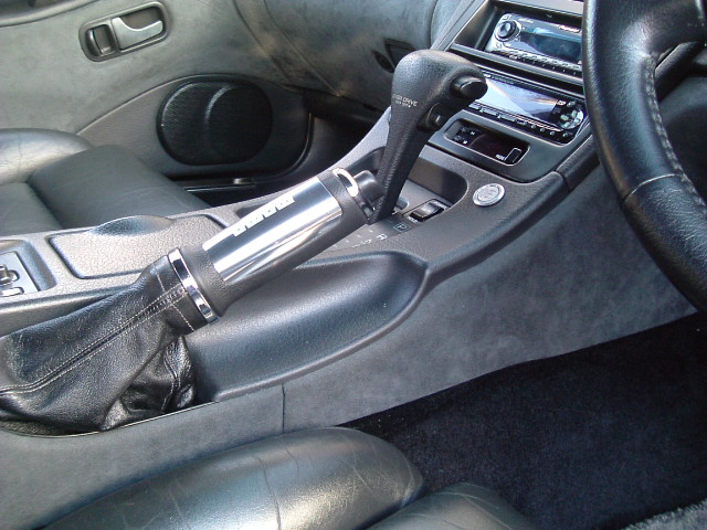

I did mine a couple of years ago but I am going to get it redone professionally this year. I removed all the old tweed except for what was on the doors, used that as a template for cutting out the new alcantara and got an Aunt to do the stitching as the alcantara would not sit right on the tight corners. I used an expensive alcantara which I have been told is a lot more difficult to use but has a much better feel about it, I have attahced some pics but bear in mind it is a couple of years old now and not looking as good as it did when first done.
