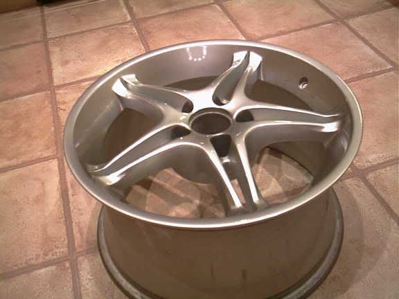

Has anybody else got AVS alloys on they seem quite common on imports , or has anybody fitted Pirelli P Zero.s on there zed ????
The reason i,m asking is after having my alloys refurbished i fitted Pirelli P Zero,s all round , i knew my tracking was out so i got it into work and did a 4 wheel alighnment , rear track was slightly out and the front alot out , camber and castor was in tolerance , sorted the tracking , job done i thought.
When driving now at slow speeds my car seems to want to follow every bump and hollow in the road , the steering pulls from side to side trying to follow the undulations in the road surface , its quite alarming
Would wheels with the wrong offset cause this , i don,t know the offset of these wheels i,ve got :headvswal
or could it be the tyres as it pulled a bit before changing to Pirelli,s but i put that down to the tracking being out :confused: :confused: :confused:
These are AVS alloys
Thanks
