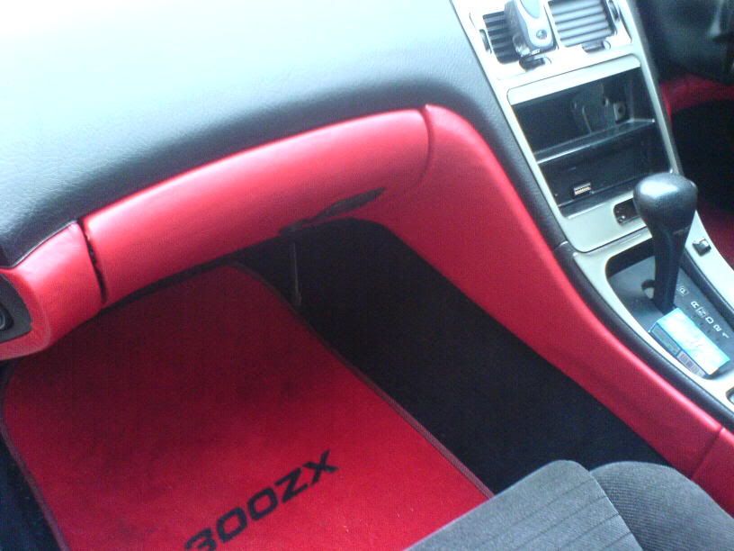

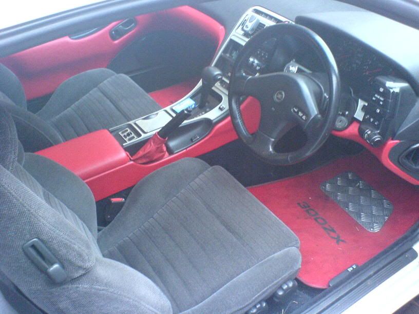

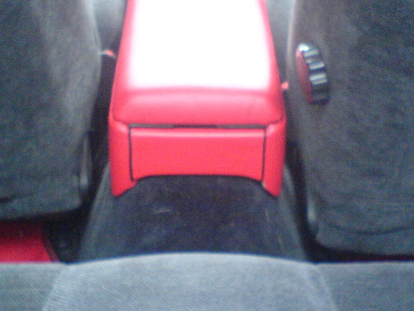

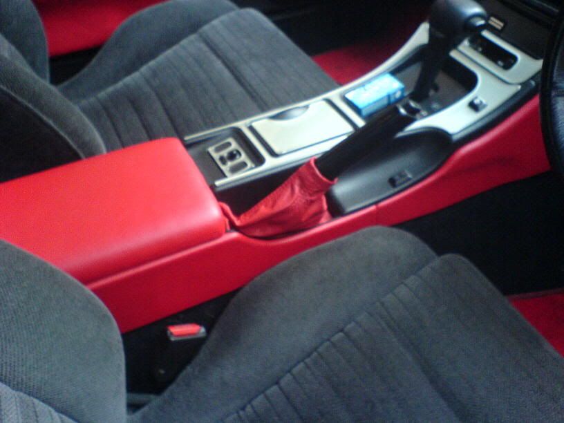

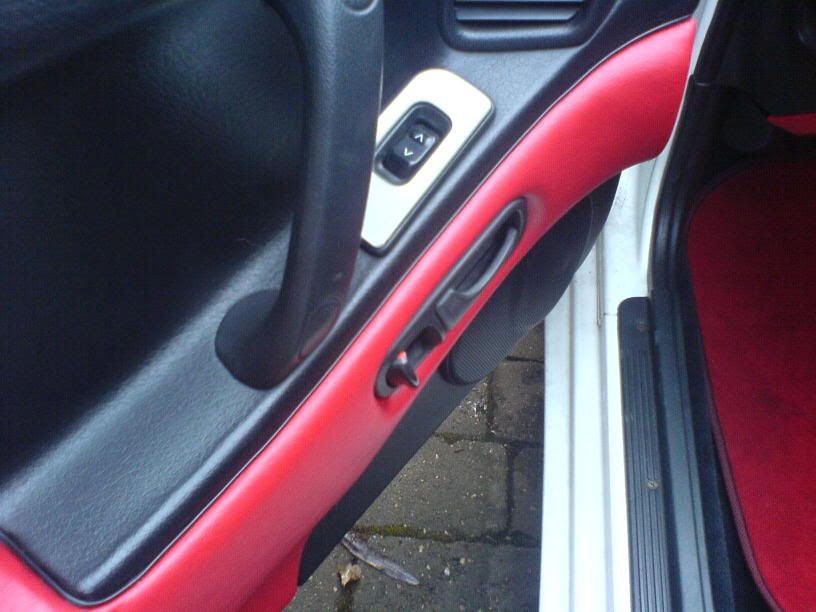

This is what I did myself in vinyl. About £40 for vinyl, bought a staple gun, £30 in glue and a couple of pounds for speaker wire to trim top of doors.
Personally I think leather needs to be done professionally, requires stitching IMHO to fit right.
