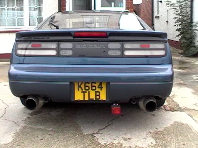

rear light are done......
Did my rear lights today, the 99 spec look........
NEVER EVER AGAIN....... !!!!!!!!
bloody messy, my fingers are hurting, my overalls are ruined....!!!!!
but worth it......
from this......
to this..... :dance:
thank fook its finished....
APACHE - once again thanks very much.....
Andy....
It's not the 99 spec look, but it does look a million times better than before. Nice one. :)
looks gud mate!!

ok ok, its not quite the 99 spec look but it near enough and loads better than those crap light covers.........
i'm pleased with them....
thanks guys...
Andy...
I think they look great. the wheels are excellent too.. :) :cool: :D

Hows this mate?
wicked - BUT FOR GOD SAKE, GET RID OF THAT FOG LIGHT !!!!!!!!!
do the rear light conversion, its a piece of p**s to do, you can get the rear inner brake lights wired up as fogs.......
search the forum for how to do it.... here you go.....
http://www.300zx.co.uk/forums/showthread.php?s=&threadid=16572&highlight=brake+wiring
cheers
Andy..
