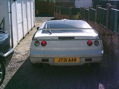

If you look at the picture below you will see that there is an inner light to each outer. Starting from the lights closest to the wheels I have used them as indicators, next ones in as brake (remember I have high level and tailgate brake lights) and the inner ones are reverse (I also converted these to accomodate H3's as I live in the sticks and converting a couple of barns so you need to see where your reversing. Just incase anyone has left the JCB or pallets of bricks etc in the wrong place.
Then in the vent at the bottom of my bumper you can see two reflectors Which are also my rear fog lights

Thanks mate , just a few other things to ask if you don't mind, the brake light lenses appear white do you have a red bulb in these, also same question about the indicators do they have amber bulbs in ?. could the whole of the lights be *smoked* as has been suggested to reduce the brightness ?
