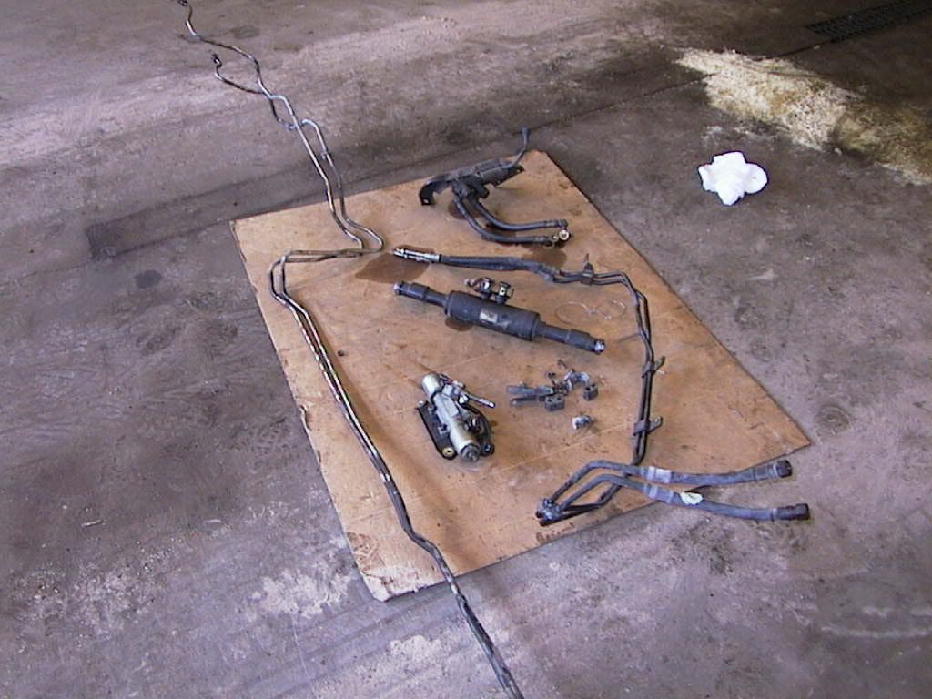

This are picture to help.
As you can see, there is a brown wire cable. I was wondering if I could not just only disconnect it ??

Disconnect the plug circles in red, and Bridge with a terminal connector.
As a quick and simple way to try it without hicas. Fit hicas eliminator (and strip it all out if you want) for a more permanant removal.
