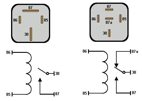

think the numbers on the bottom of the realy are like 30 (ish) 85 and 86 and then another (not very helpful but assuming someone knows these and i can connect one fo these to the other side of the fuse and get sidelights..)
HTH on my zed which is an import if i just put front fogs on all my rear side lights work you may look like a boy racer but at least you can drive it home till you can sort it properly :headvswal
Here is relay layout and pin numbers etc.
Jeff TT

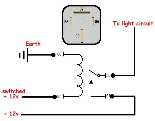

thanks jeff, so from this assuming the fuse is going to the lights which connector off the relay do i need to use to have the side lights permanantly on? (when i come for serivce Il probably get you to give this electrical thing the once over as well!)
Thanks andy
Right, below is an idea of how the circuit was MOST LIKELY connected, be aware though that you must check with a test meter because it may be slightly different the earth connection to pin 86 and the switched +12v can be reversed as they will energise the coil of the relay either way.
Also pin no 30 and 87 may be the other way around because this is just the switched circuit and will work either way around
The other concideration is where the non switched +12v has been taken from, is it fused? is it from a circuit which can support the current draw etc.
Sorry to sound a bit vague but at least you have something to go on.
Jeff TT
thats great thanks, i will have a look and try and work out what is going on in the mess of wires there
