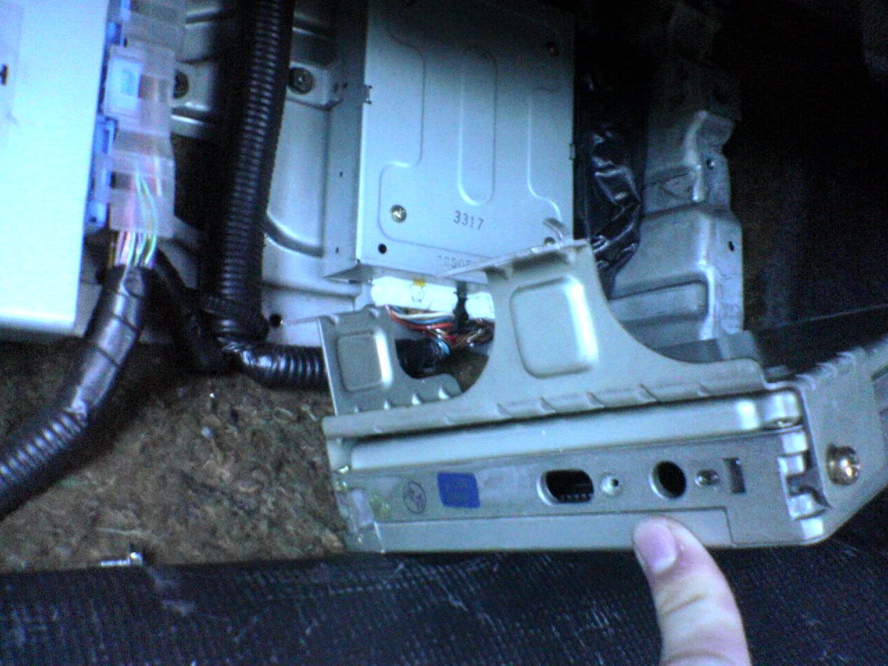

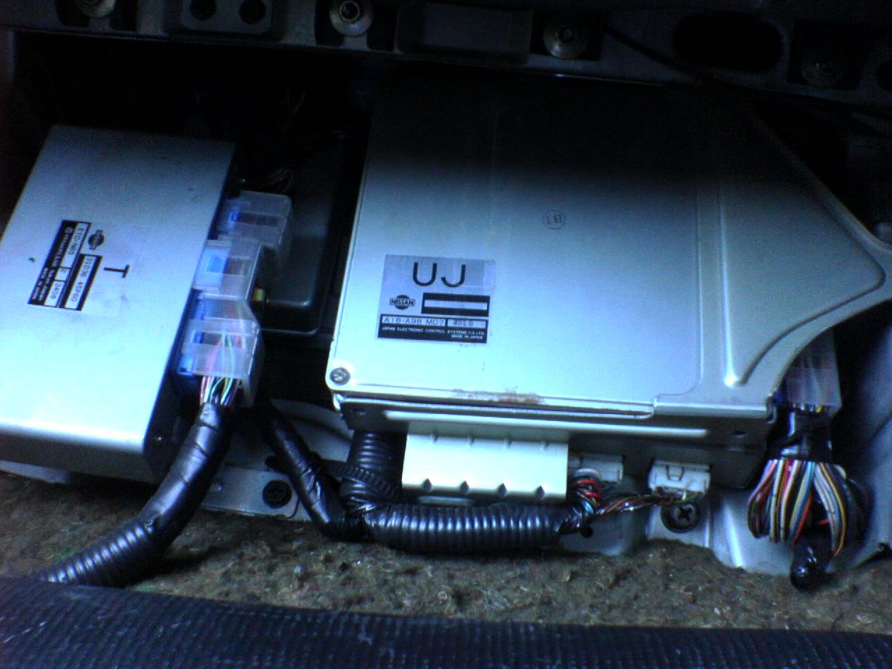

Ok, im trying to do whats on the ECU test thing
this is what it looks like in the first instance

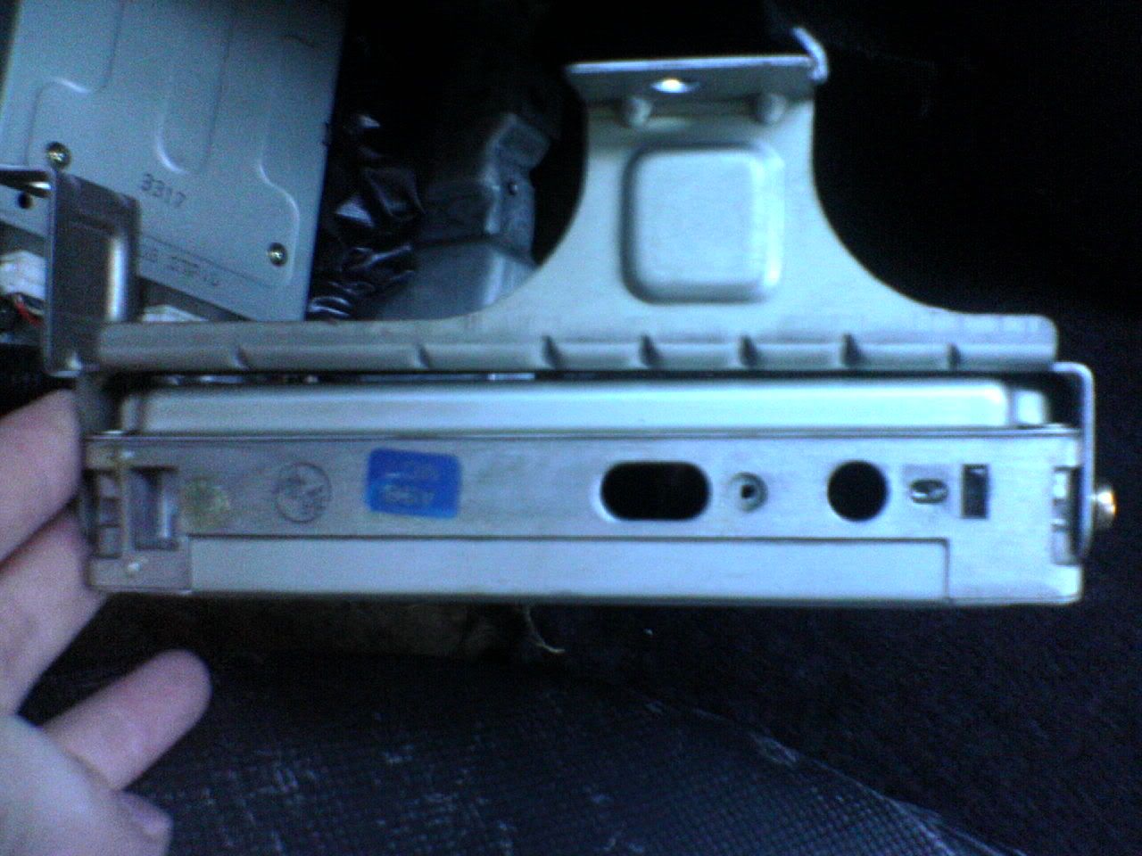

the only oval holes i can see are on the left on mine (its uk if that makes a difference)
now i can see the oval hole and it has i think a green little light and a red one, and for the small round one, i cant see a screw in this :headvswal
also i can't find any pot at all that i could turn :headvswal
help please,

Look for something that looks like a screw thats sunk in slightly (gold in colour if memory is right), it wont undo it will turn about 180 degrees in either direction very easily, thats the one you want to be turning. There is a little LED next to it that will flash.
not *all* ECU's have this screw (mine doesnt)!
I prefer to use the method in the manual where you short to pins out on the diagnostic socket

but again it says to turn the screw which isn't there to turn so i screwed on doing that
Membership No 0780
INSURANCE GOOFA
click on the page to take you to the next page - it then shows you a flow chart of what to do. 1 method involves turning the screw, the other shows you to short 2 pins with a piece of wire ;)

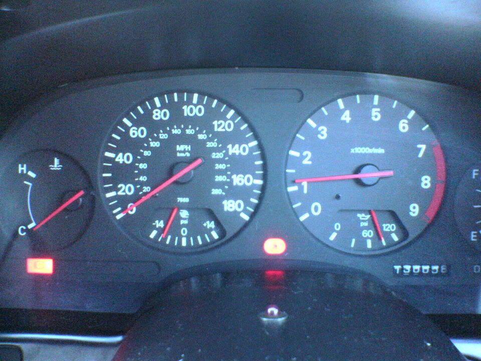

when i start the car from cold should the psi and oil pressure look like this?
Boost guage is a little too far to the right (should be on the -14), which often indicates boost leak. No gaurantee though, as the gauge can be very innaccurate.
well im going to take it too a garage for them to have a look now so hopefully they'll know the fault and it wont be too expensive
