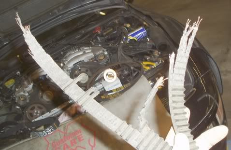

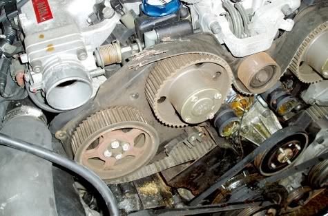

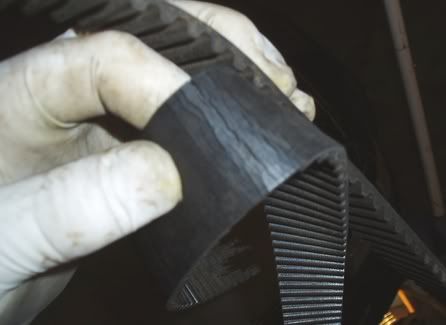

Have a look at what a cambelt look`s like when it breaks at motorway speeds, very basically the belt was way past its due date as the last picture shows and was going to go at any moment.
Now your thinking valves and pistons etc arn`t you? well this guy must have had a lucky day because despite what you see there was NO DAMAGE! a new belt, pump, pulleys, stat etc and a perfectly running engine, all compressions well within spec, now I call that lucky.

Owner reported that he just felt the car cut out (auto box ) and he pulled over to the hard shoulder and called for a toW truck, good plan eh?

The irony of it is the car was booked in to have the belt swapped anyway before this occurred! JUST BOUGHT IT FORWARD A BIT.

After a 25 mile run today all is functional correctly, given the luck this guy has I will be asking him to choose my lottery numers this week! :D
