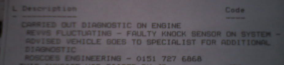

here is a quick photo of the printout.
faulty knock sensor would not cause flutuating idle so dont know what there on ;)
LOL, yes and these are the experts. They charged me £48 for that piece of info... Im dissgusted. I might get better infor from a fortune cookie.
"they told me what it wasn't and to go else where." :headvswal
