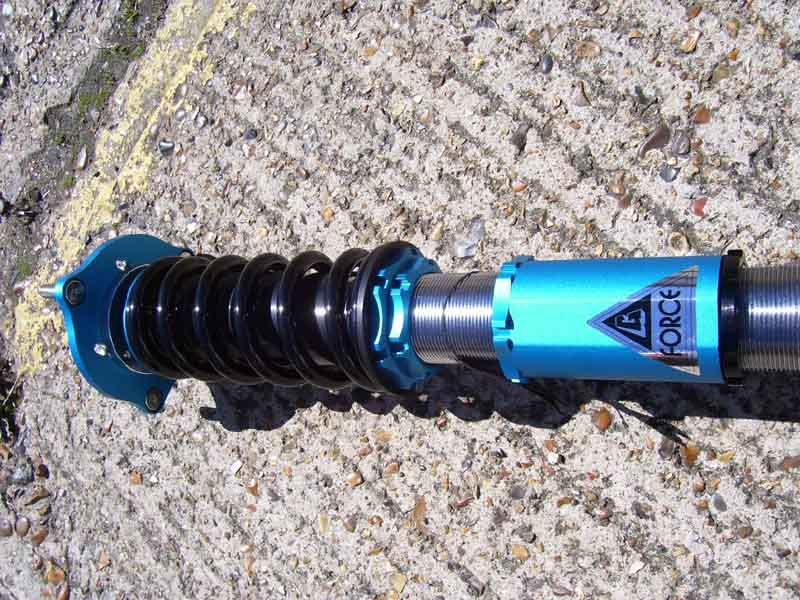

Been looking around for some decent coilovers and came across these being sold at just £525 which is really good and done a search on the company and all looks well :)
Features are:
Full length adjustable shocks, meaning you can set the ride height without making the ride crap at the same time.
Spring pre load adjustment
Full height adjustability - they can go LOW
Upper mounts included
32 way adjustable damping
Warranty is provided of course. You can also specify the spring rates you wish to have and your damper set will be re-valved accordingly to best suit the springs you choose. Spring rates are available from 4kg to 22kg front and rear.

My chosen spring rates are 4 to 5 keys cos my Z is being kept as a GT car not a racer and I have just received 19" rims from the US so im trying to keep to softer ride. I really wanted to get a fully adjustable coilover and thats the problem according to some of the guys on the Skyline site the G-Force Coilover adjust real low but cant be jacked up. They will need an increased thread length.
Dan is working on that for someone and I need to speak to him and ask him about that.
