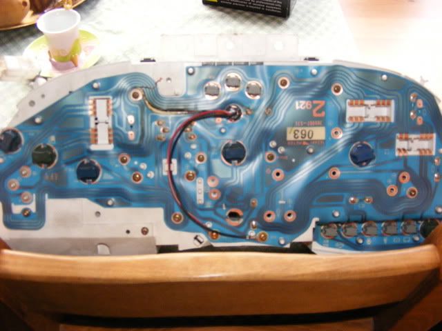

My fuel gauge still doesnt work and is allways reading full. Heres the story. all working fine when I removed to fit the indiglos. Fit the indiglos and put it back together and goes straight to full. Take the clocks out and check all connectors etc all good, remove the fuel gauge and reflow solder and check resistance all ok. Put the clocks back in, still reading full. My head is getting fried with it. Dont know what else to do and cant afford new clocks. Does anyone have any suggestions (sensible ones i dont need winding up anymore)? Is there an easy way to test the sender as the only thing i can think is it may be purely coincidence that the sender has given up and the same time as I changed the clock? Or is there a fuse for the fuel gauge that might have gone that will cause the problem? Or finally does someone have a set of clocks i could borrow to plug in and try?
Lastly if you look at the pic of the back of my clocks you will see a burnt out wire, thats always been there but could it be causing the problem?
