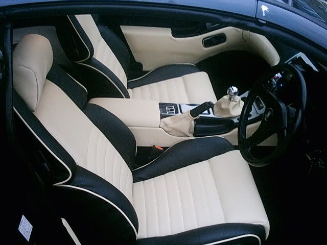

You mean like this ?

Yes, like that but different colour, did you do that yourself or get it done professionally $$$$$$$$$$
It was done professionally, £450 fitted.
Um blimey!!!! When was that? 1912????
Really mate thats a fantastic price, ah hang on. that will be the price for just the trims ect not the seats too yeah?
£450 was for the whole interior...
doors, back panels, lower dash, and all seats.
the guy that did it, is also doing one for another member as we speak.
Does that mean you have a couple in the back? If so who is this guy :bow:
The guy's business is called Jack Smith's, he's based in Swansea, in south wales, any one interested, ill pass his details on if you pm.
this guy was recommended to me, and he did a good job for the money.
