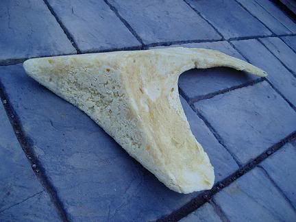

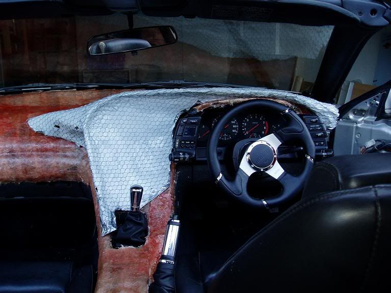

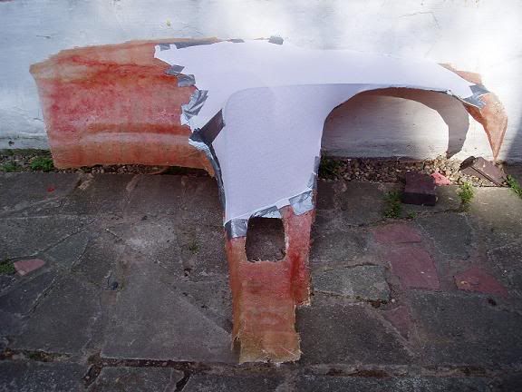

Well, there's been a bit of progress since I last posted. My first attempt which involved filling a make shift mould with expanding foam sort of worked although it was very rough:

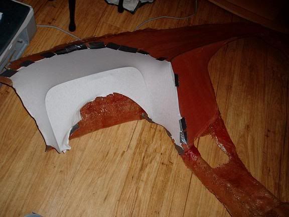

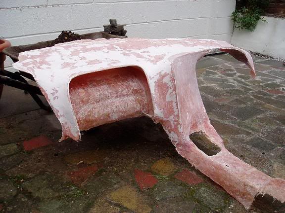

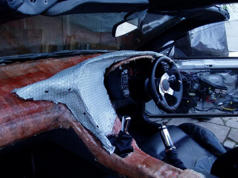

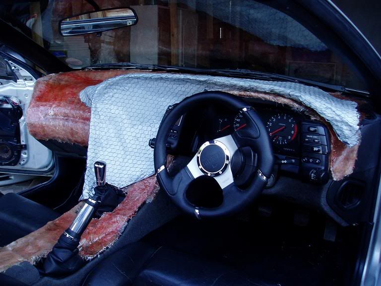

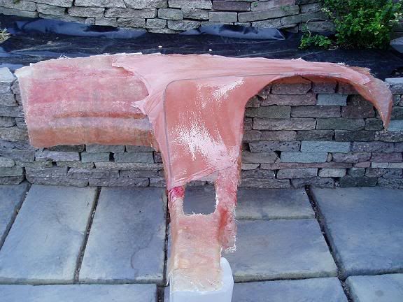

In the end I decided I didn't like the shape and that it would be better to build a wire armature, stretch fabric over it, soak it in activated resin then fibreglass and filler over the top. It's still very rough and very much a work in progress but I'm happier with the shape, and importantly it fits in the car! A hole for the screen needs to be cut out in the swept centre console (it will be recessed into it to avoid glare...I'll use resin'd fabric again to make the sides of the hole flow into the screen and the same method on the passenger side screen). TBH I may end up scrapping it and making another though, I'll see how it goes.
