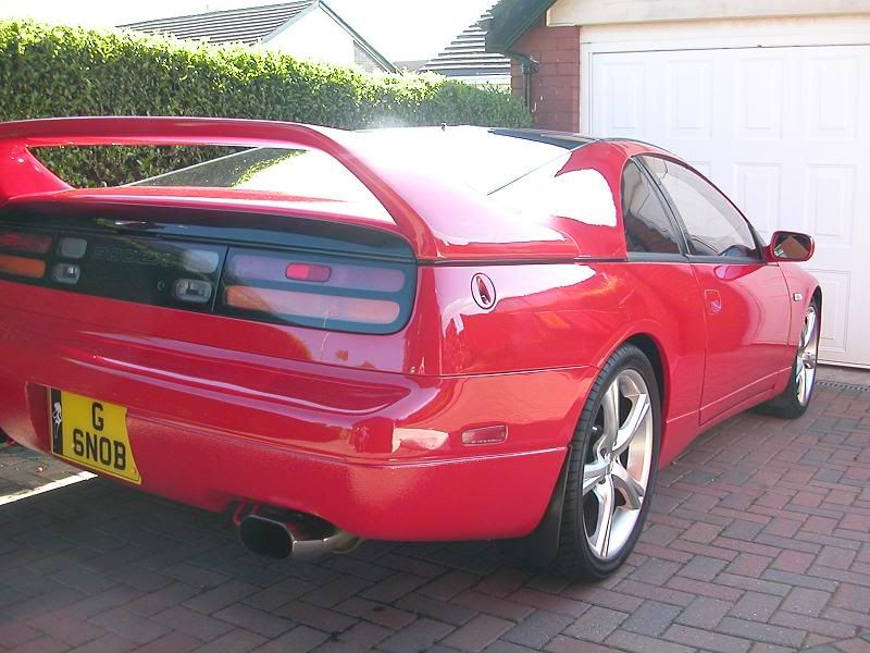

I'm running a Powerflow cat-back system on my twin turbo, and I'm rather chuffed with it. As previously stated, they used to have a bad name, but I took the chance anyway. The welding is no work of art (could just be the particular guy that did mine) but the whole system is made to your own spec, so you can have it as loud or as quiet as you like, and there is a massive range of tailpipes to choose from.
I must say though, the fit was excellent - mounted nice and solid, no rattles or bangs!
Best part was, only £400 all in - happy boy :D.
