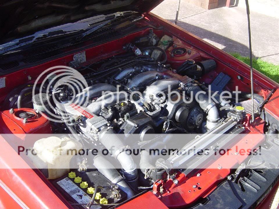

Here is a few pics of my Greddy 18G and Pentroof;)
aggggghhhh ok ok ok - so you have every mod known to man - i saw the fury dice hanging from your rear view mirror
and the max power logo :shock: ..........
...... actually you do have a max power logo :D

Nice set up MAC looking forward to seein' that baby in action. Don't forget to let myself and everyone else know when you are gonna launch her down "THE STRIP" 'cos I wanna be there to see her kick some serious ass or asses.

Cheeky ****in **** LOL:D
