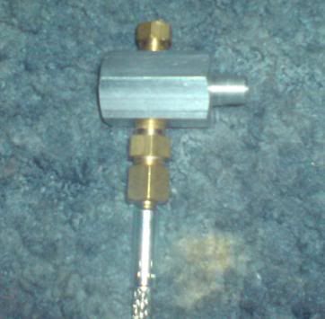

i have one, its a triple adapter :)
has 3 take offs, 1 at the top (where gold bolt is)
1 at the bottom (where braided hose is)
and 1 on the side (nothing pluggd in)
can run the standard oil pressure sensor, aftermarket oil temp and after market oil pressure.
i had this from gaugeplace.co.uk if anyone wants to know.
about a tenner?
cheaper than a sandwich plate

Does that screw into the sump? or the stock oil pressure sender point? just asking coz you cant gauge oil temp correctly from a pressurised location.
sorry, it goes to the stock oil pressure location.
(that not good for temp?)
hows that then?
how much out is the reading?
