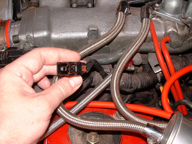

stock solinoid connectors - where?
Just checking the wiring and piping on my boost controller install which I still have problems with. Can someone tell me which are the stock solinoid connectors. Thanks.

There are two stock boost solenoid connectors.
I found a tech document on the net, sorry cant remember where but it was a guy showing step by step of installing a blitz dsbc controller.
The connectors are near the pcv valves look for black with brownish ends connectors, these need to be disconnected.
The passanger side one is near the dipstick and the drivers one is near the brake and clutch fluid reservoirs.
thanks for reply. Just checked and they are right ones disconnected. Should the pipes going from the solenoid to the actuators be disconnected aswell?
No. leave these alone.
the aftermarket boost controller box should have been connected to the pipes from the small intercooler pipes.
How the original works is that the small pipe from the intercooler pipe goes to the wastegate actuator and you need to disconnect these pipes from the intercooler outlet and connect new pipes to the end of the intercooler pipe where u just disconnected the original pipe and using a tee piece connect both these pipes to the in of your new controller valve box , the out of this valve box then tees off to both the original pipes which go the the wastegate actuators.
bit vague but hope helps.

These are what you need to unplug;)
