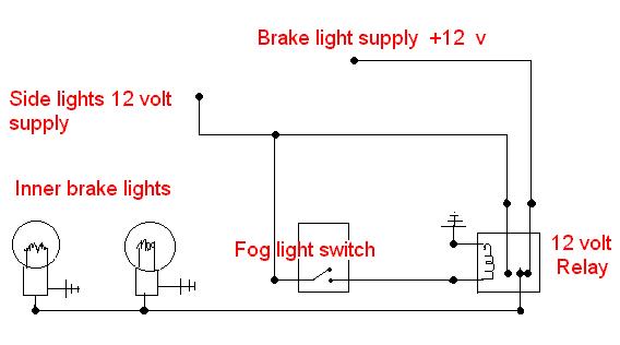

Here is a more simple wiring circuit, just link the two back lights and one relay will do it all.
Nice, Thanks Jeff.... expect a mail from me soon to arrange a 60k service for my new baby.
