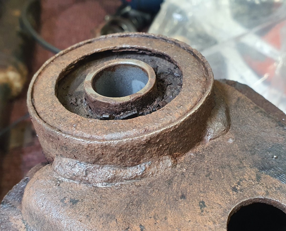

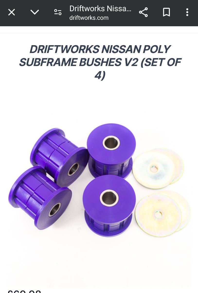

Just taking subframe bushes out at the moment. I was looking to fit the driftworks purple ones like in the pic. Have I gone too far with removing the sleeves. Or is my option now solids? Many thanks
Hi yes I think so 1 sleeve too much.

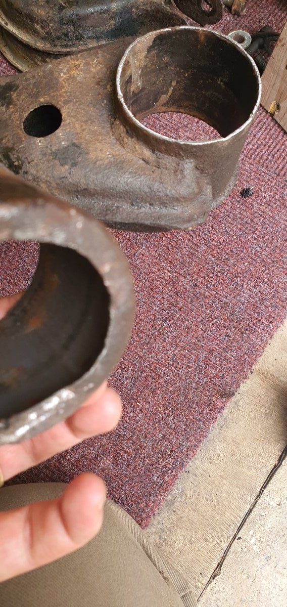

Cheers just doing some head scratching
Trying to figure out how these would even fit with the outer sleeve still fitted as the underside one wouldn't fit through
Not sure how the purple ones in the pic would fit with the outer sleve still In as the sleeve has a shoulder.🤷‍♂️

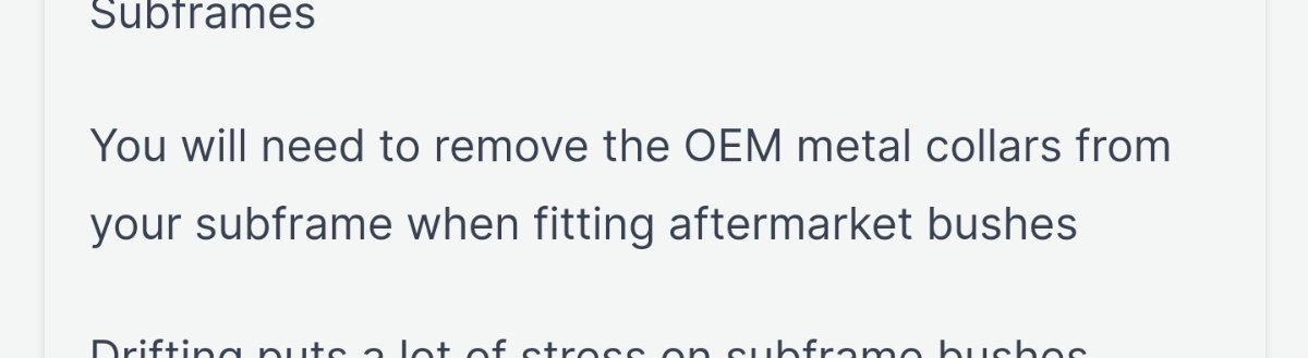

I see what you mean with those bushes, looks like they need both sleeves out.

I have conflicting memories in my head. One part says for polys you are supposed to retain the outter ring. The other, that they sit in there.
The top flange is supposed to push the frame away from the body. The rear subframe has lots of anti squat built in and this helps reduce this making the car easier to launch.

I think i removed 3 layers of rings when i remived mine
