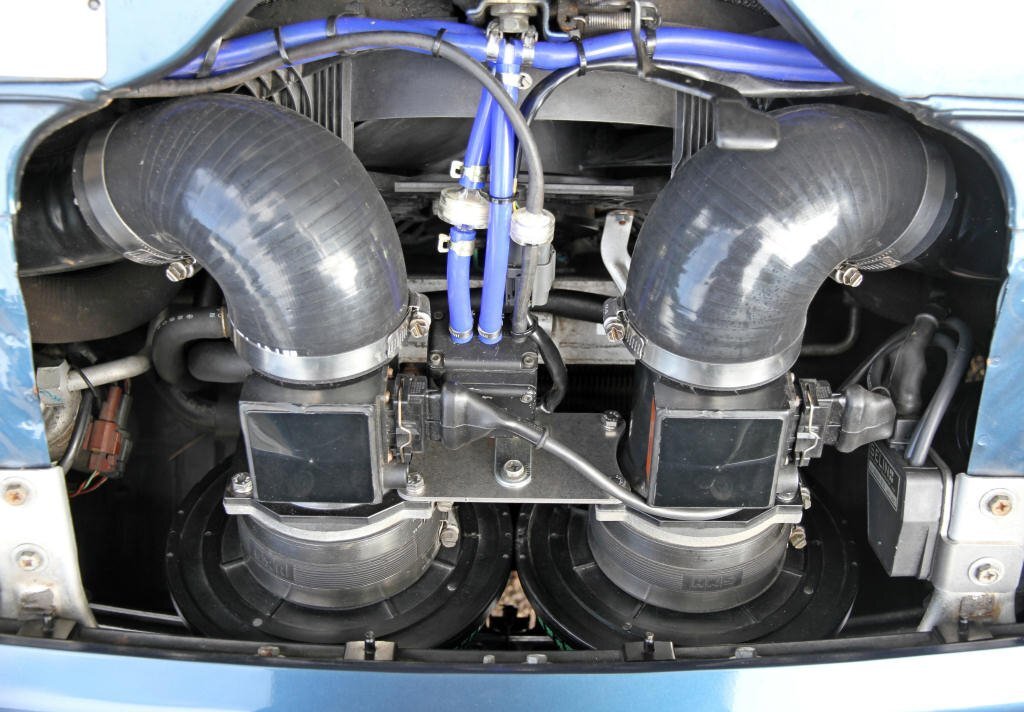

For my HKS EVC4 install the setup. BC Solenoid mounted so roughly equal distance for hose runs between both wastegate actuators
and between TB intake takeoffs (small blue hoses T'd off from soleniod running to both wastegate actuators and both intake takeoffs).
This setup has been in service for over 15 years without any issues.

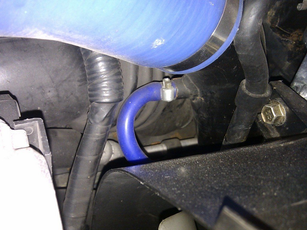

This is for RH TB takeoff using existing nipple in intake pipe. Large diameter blue hose runs up to TB.  LH side is the same setup.
Single takeoff from balance bar for boost pressure signal to BC Soleniod.
