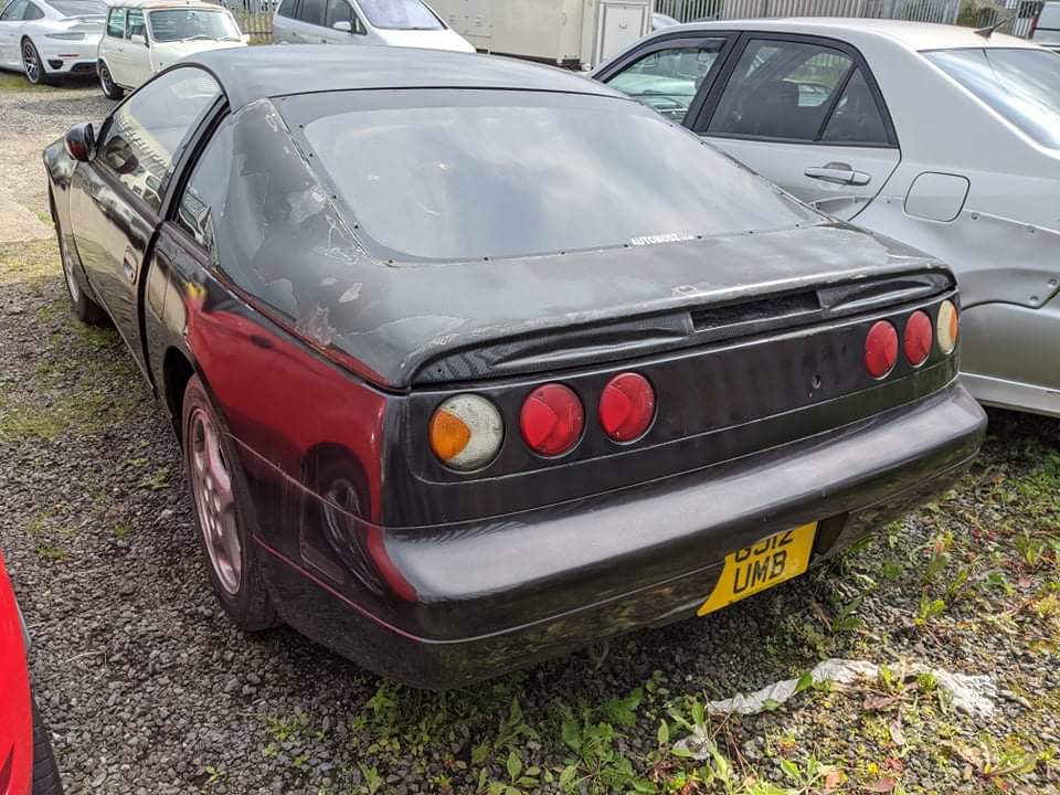

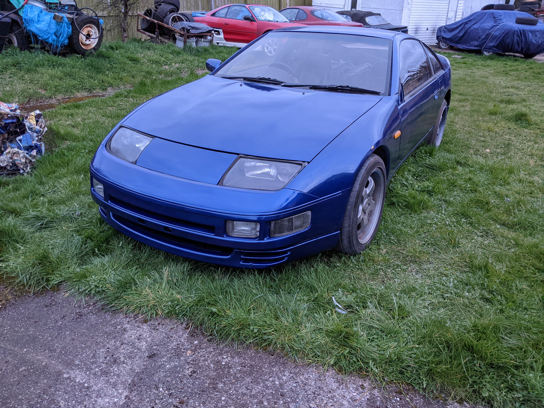

But yes I went to a friends lock-up filled with various skylines and silvias 'Drift missiles' but in the corner of my eye this got my attention.... Its a SWB slicktop! wow! i never really liked the T-Bar, so i bought it with a huge job ahead of me...
To those that recognize it.... YES IT IS SLICK PETES OLD 300zx!!!!!! So if anyone has any more information or pictures please sent them to me!

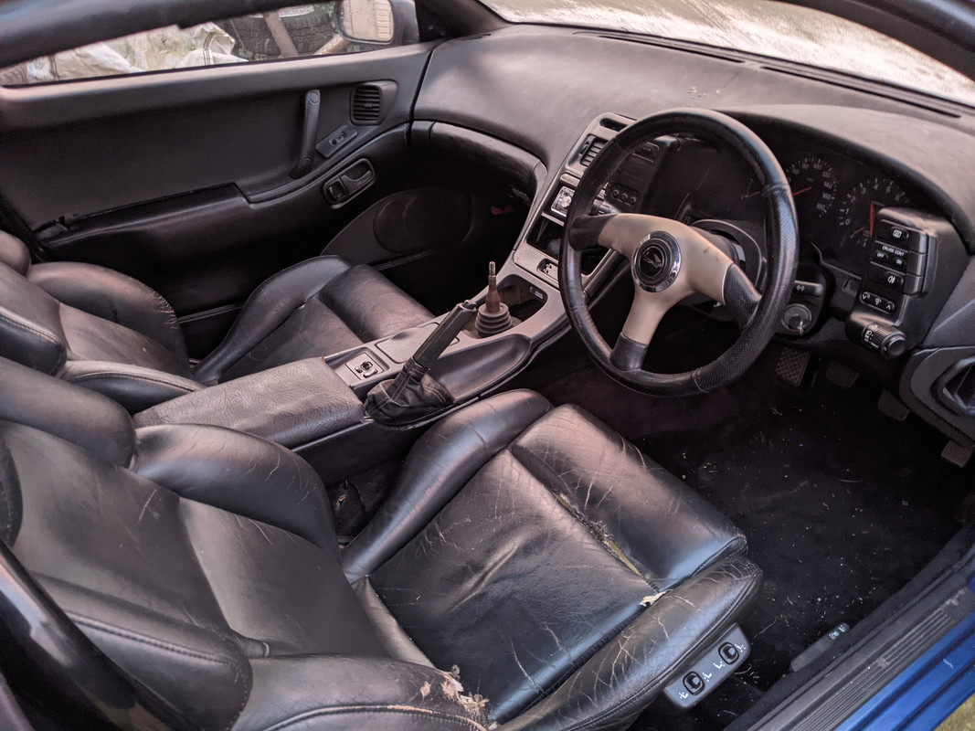

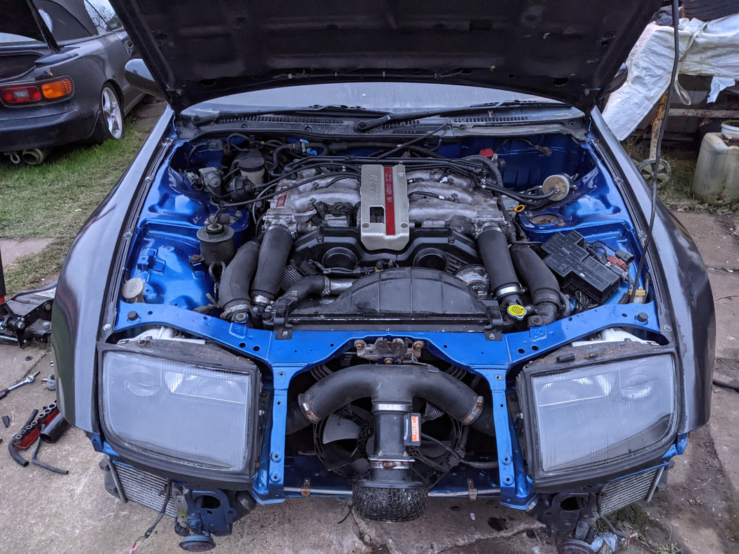

From looking at the wiring, it appears the car was a Naturally Aspirated Automatic, however the car how has a fully rebuilt vg30dett with a manual gearbox, also with the TT rear Diff.
It has brembo front brakes, polybushed and adjustable arms arms all around, subframe and diff mounts are polybushed too :)

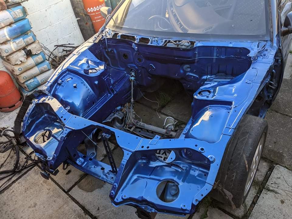

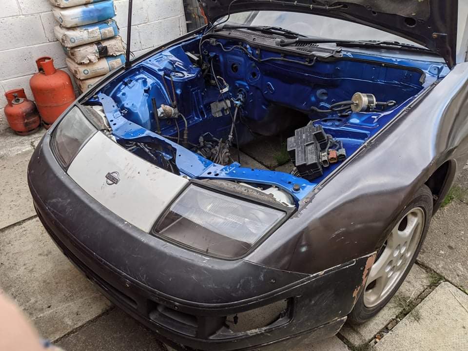

then heres when the real work began haha, whilst the engine was out I cut our all the rust and resprayed the engine bay.

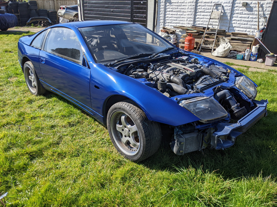

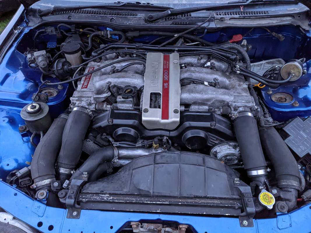

managed to get my hands on a DETT and rebuilt it.

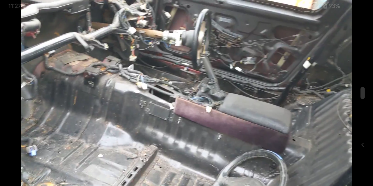

built up the interior :)

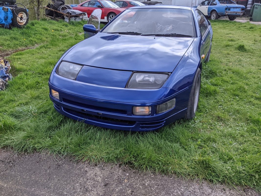

Once the car was up and running, i then focused on bodywork!! gave it a lick of paint, impressed myself with the results!!
This is how it looks now :) the car is far from complete but it is progressing!

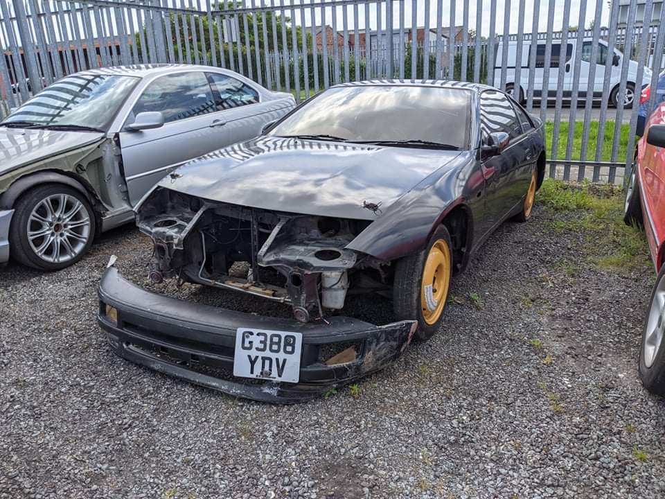

Thanks Gaz, it was going to be used as a drift car, I couldn't see that happen! yes I had a look at every post of his, managed to source pics of the damage!
