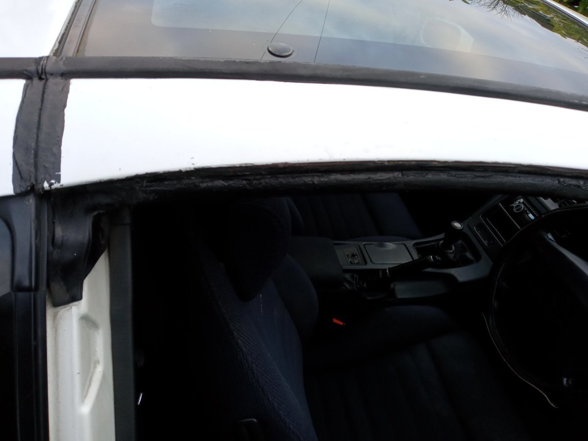

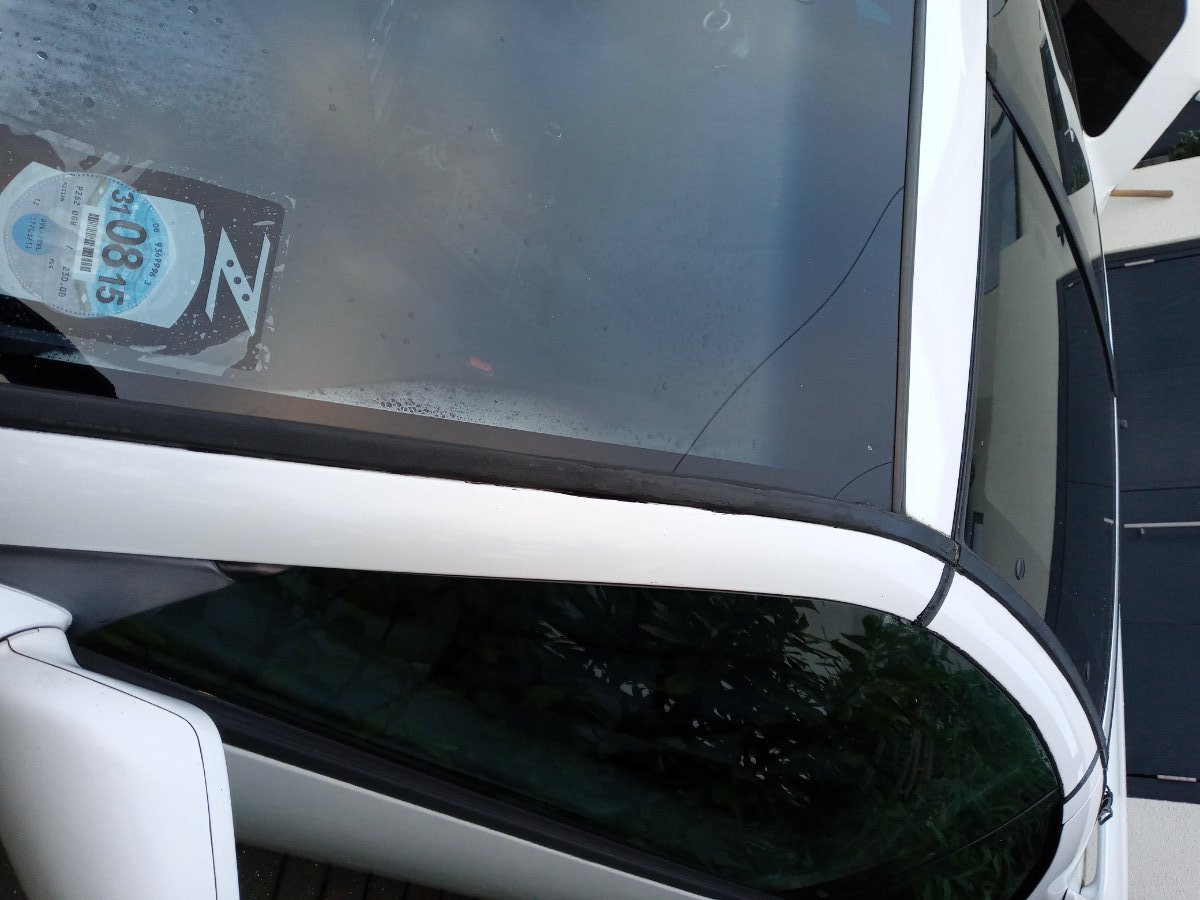

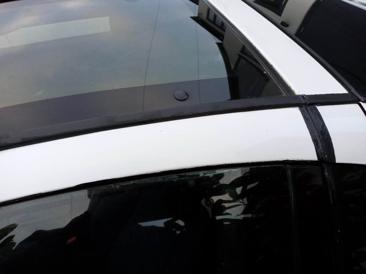

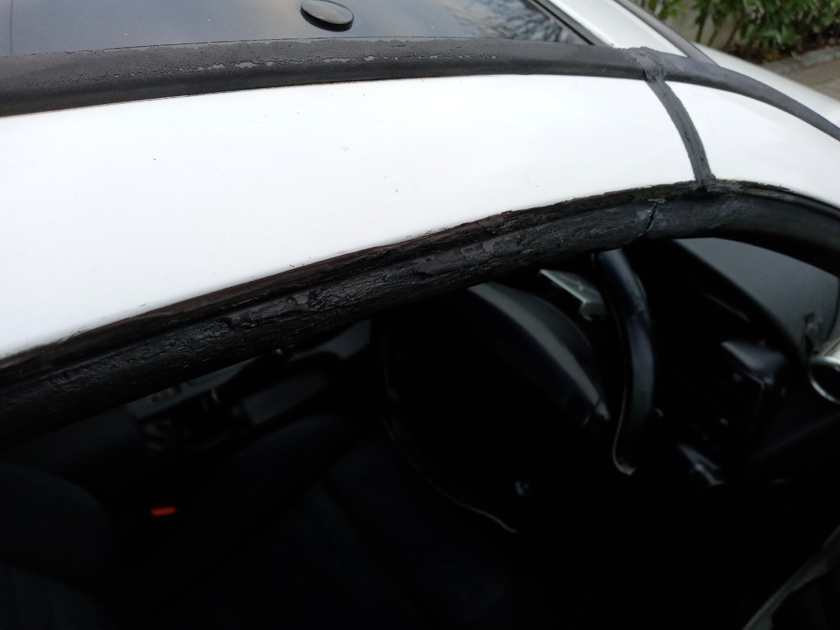

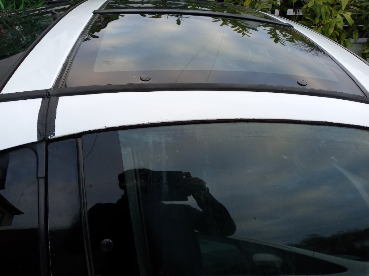

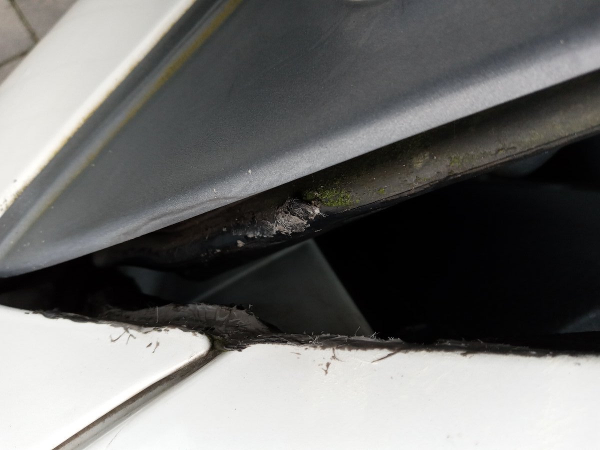

My car leaks on both targa sides, I know this can happen, but the seals look knackered. Also they look swollen and bloated, the previous owner must have applied some black silicone stuff to seal leaks, but it looks really irregular and rough spoiling the clean lines. My plan is to get the car resprayed and replace all the seals.
I would be really grateful for suggestions on where I can get the seals (targa and door) and what your thoughts are on trying to restore the targas, seals and the original paintwork.
depending if your car is LWB or SWB targa seals are available new from CZP or Z1, door seals for SWB are available from the same sources but unfortunately LWB door seals are no longer available.
Assuming your car is a 2+2. Part #'s
Windshield Molding - 72760-30P00, 72761-30P00
T-top Molding - 91784-32P20, 91785-32P20
T-top/Hatch Rear Molding - 73852-32P00, 73853-32P00
Targa seals (OEM and replica). Part #'s
https://conceptzperformance.com/search.php?search=t-top+seals+2%2B2&filter=1
2+2 door seals NLA from Nissan, but worth checking US, Europe and Japan as may be lurking in a warehouse or retailer.
Otherwise s/h (try https://www.banzaibreakers.com/) Part #'s
https://conceptzperformance.com/search.php?search=door+weatherstrip+2%2B2&filter=1
For UK supplier of Nissan parts with a good reputation try https://www.allcarpartsfast.co.uk/
