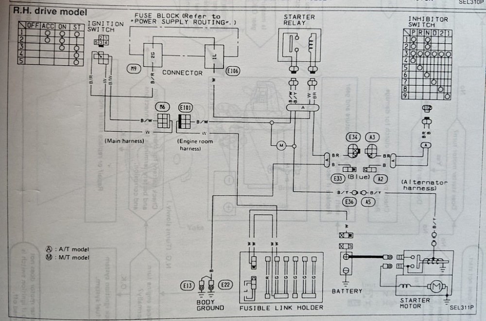

In need of a wiring diagram which covers the full starter circuit from ignition to the starter and the full engine wiring harness
Hi
ues the car is a RHD 1990 vehicle.
Not quite understanding diagrams, since they show 3 out of the 5 wires for the ignition switch. Any pointers for me.
I frequently use more modern electrical schematics which are very differently layouts
much appreciated

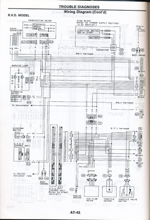

Sorry, you asked for the starter circuit. This is the full power supply routing circuit diagram for a RHD car which includes the other
circuits running off the ignition switch. Use the two together for the full picture. You OK with the wire colour coding?

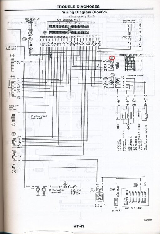

Do you have the pin-outs for the connectors in the centre console? (Where the gear lever is)
I have looked for the inhibitor switch block, but found nothing.
My son has bought a 300ZX, 1990 Model, and they have literally cut into almost every wire looking for something to connect the radio to.
I basically want to install a kill-switch - so the car can't be started without a second key.
I have looked for the tell-tale signs of a jumper, indicating a Park/Neutral switch - but have found nothing. Yet.
