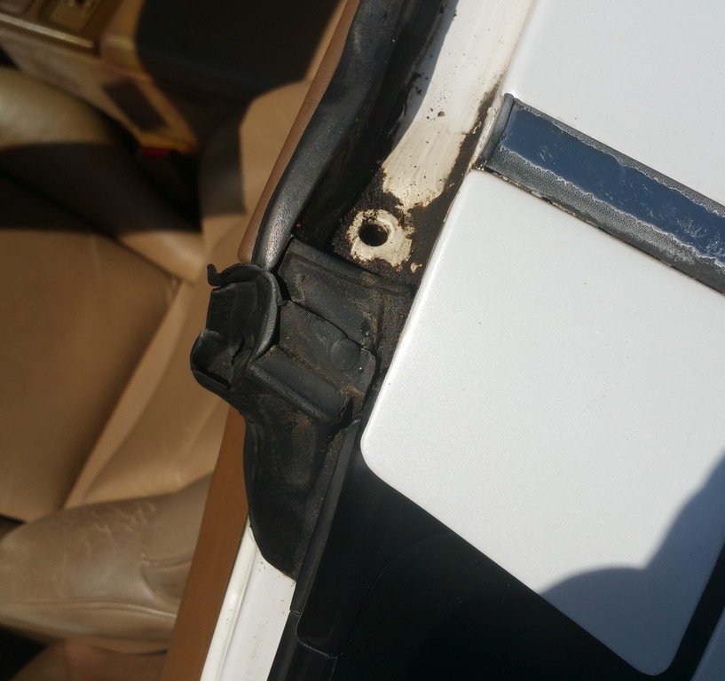

Yes, you can run water down the drain hole at the rear of the targa (pic shows n/s but same for o/s). It should exit via a plastic pipe on a good
sill in a exit slot formed in the lower edge of the sill.

Ok, just went to check as that would probably keep me up at night.
The water runs down nicely. you can hear it flowing down the pipe. and it exits in its slot.
The rust is only on the inside of the wheel arch. there is no evidence of damage forward of the arch and the pipe outlet is a little way further further forward, but if there is something else I check?
