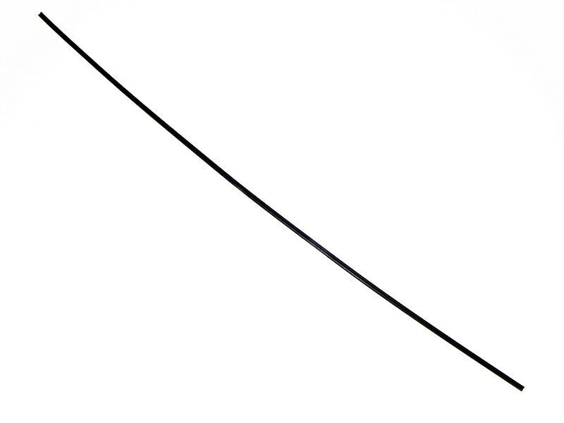

hey all, i looking for some advice and possible more pictures of the top trim that runs across the top of the windscreen.spacer.png

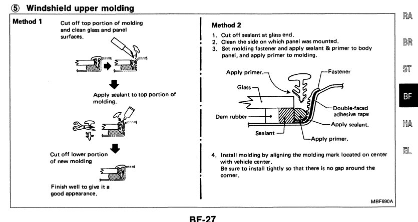

can it be replaced with the screen in situ?
has anybody got better pictures of both parts .. the best one i have found are on the z centre's website ..(https://www.zcentre.co.uk/index.php/click-here-for-parts/body-exterior-trim/300zx-nissan-windscreen-top-trim)
but i cant see the trim piece very well (the bit closest to the glass..
Andrew you are a star!!! thank you  ? so it can be done without screen removal... that's a relief..
