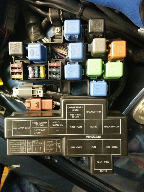

But my relays are different to these to start with. I have a twin switch brown relay under headlamp LH position. and a black one under headlamp RH position.

Headlamp fuses all checked? My '94 UK spec has the relays you describe:
That's the layout yes.
