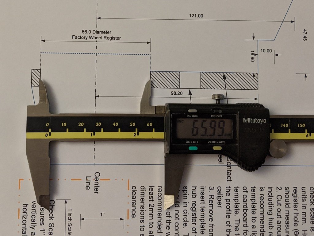

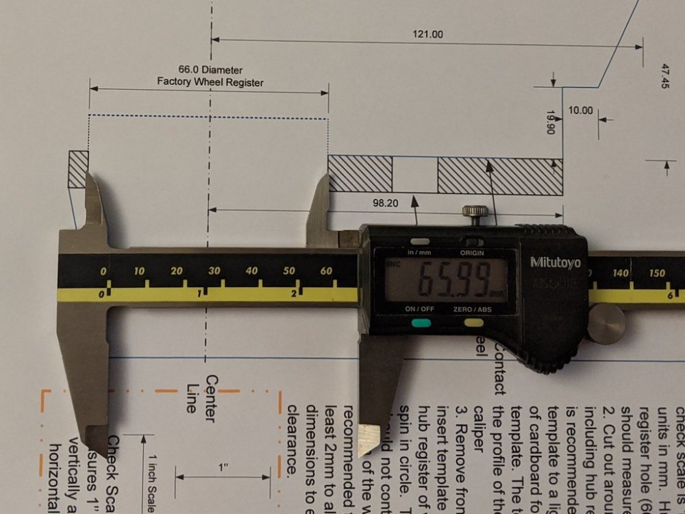

I actually spoke to driftworks today and gave them the details on the wheels for them to check against.
I have to say after checking the templates out, they have an issue. Their measurements arent to scale and i have printed using both the phone and the pc set to 1:1 scale and the measurements are inaccurate by quite a margin!
The scale is printed as stated on the instructions from the website.
So fortunately i havent used these to check the fitment otherwise id be back at square one again lol.
the 1st photo is the inch scale
the 2nd is supposed to measure 66mm20200601_211210.thumb.jpg.51c1e992d19ca83d6d1e616c0d85e86b.jpg20200601_211248.thumb.jpg.64450fffb7459327ef6abfac33899a01.jpg

That’s helpful isn’t it! ???‍♂️

Well, dont know whats going on with mine then! It was printed to scale 1:1 which is as it states and converts to "actual size" and the measurements are all over the place! Ive printed it 3 times and all are exactly the same?
