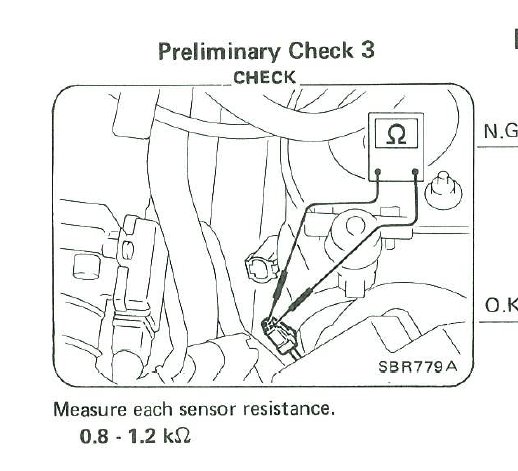

There is a test function you can perform. The ABS ECU is inside the off-side rear interior panel - essentially behind your seat-belt. Gently pull the trim away, you'll see the rectangle box - it has an LED which flashed to indicate the fault code.
Give me a mo and I'll dig out the link Andrew sent me.....
6 flashes, right front rotor sensor circuit.
Im assuming this is the ABS sensor. Anyone have previous experience changing these? I’ll go and try to find a how to. ?
