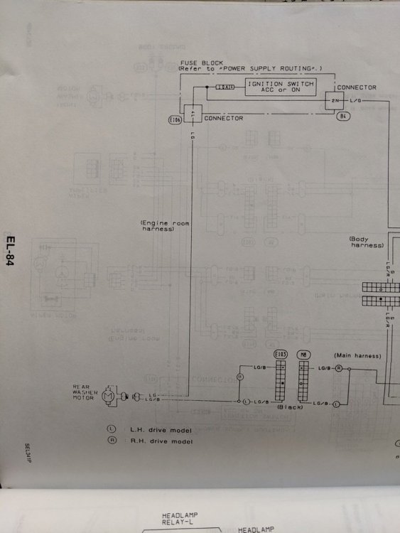

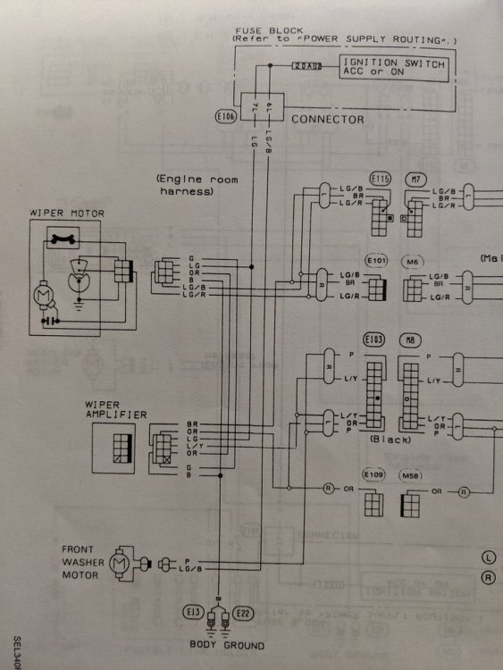

what colour are the -tive & +tive of these pumps
I have two new ones to fit
thanks
art
No just two wires with connectors.
you use the old plugs from original pumps.
i think wiring diagram says brown as earth.
but the old wires look black and blue!

Are they non OEM replacements?
Just use a multimeter on 12vdc on the plug from the body harness, negative to body ground and one of the two will give you 12v when switched on.
IIRC the one towards to centre of the car with the larger plug is the front, the smaller plug to the side is the rear. There is also a smaller one for the float switch.
Should be very straightforward.
